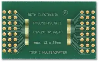

If you can get the right surface mount connector, then you might be able to use a board like this:
http://uk.farnell.com/roth-elektronik/re900-02/adaptor-smd-0-5mm-28-48pin/dp/1426156
picture for link above
as a breakout.
If you were brave, you might even be able to reflow the flexy directly onto the 0.5mm pads, though personally I would use a connector.
There are a lot of Roth Elektronik boards of various kinds - there may be something else more suitable for you specific connector.
