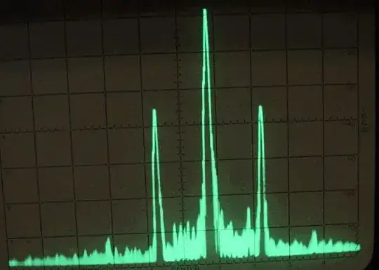

So, we look at this on the spectrum analyzer, we get something like this:
The tallest spike at the center is the carrier frequency, and the two others are the side bands (the one to the left, at the lower frequency, is the lower side band, and the one to the right at the higher frequency is the upper side band).
If we synthesize a modulated wave form by simply generating 3 perfect sine waves at slightly different frequencies, and then run them through an FFT, we get a rather cleaner display:
Either way, what we have is three sine waves all being transmitted together--but each is still just a normal sine wave like that shown in the first picture above. The only thing unusual involved is that they're at three slightly different frequencies (and as we see in the amplitude plot, the result no longer looks like a sine wave).
Putting them through a diode won't change that basic fact. We'll just have three sine waves at different frequencies, but with all the negative (or all the positive, depending on the diode's orientation) removed. So each of the sine waves will look like this:
...but we'll still have the upper halves of the sine waves at all three frequencies, so on the spectrum analyzer it'll still look roughly the same as it did without the diode. It does change a little bit (because rectifying it obviously changes the shape of the waveform) but not drastically.

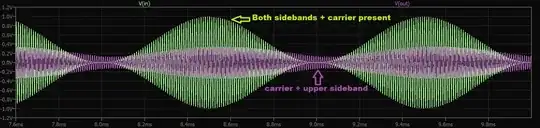

Shown below is a LTspice simulation showing a 100,000 Hz carrier modulated by a 1000 Hz sine wave.
  • Green waveform shows 100% AM modulation, with both sidebands present along with carrier.
  • Purple waveform shows the same with lower sideband missing (full carrier with USB -6dBc)
green waveform:standard 100%AM purple waveform has LSB attenuated
The simulation is imperfect. Had it been perfect, the purple waveform would have reached |0.5| where the green waveform reached |1.0V|.
And where the green waveform dropped to |0V|, purple waveform would have bottomed out at |0.25V|
Where only one sideband is present, it appears similar to 50% modulation, versus 100% modulation of the green waveform.
Below, the 1kHz modulator has been modified so that carrier at 100kHz is suppressed:
  • V(in) waveform in green has LSB at 99 kHz, and USB at 101 kHz. NO CARRIER at 100 kHz. Both USB, LSB have same amplitude.
  • V(out) waveform in purple is USB (101kHz), with LSB (99 kHz attenuated.
carrier-suppressed-modulator waveform with LSB filtered out
This last method was commonly used to generate single-sideband for radio transmission. You can use a double-balanced mixer, or a four-quadrant multiplier for the modulator (both can suppress carrier). The RF filter to pass one sideband while rejecting the other sideband usually required a multipole crystal filter.
Station CHU actually transmits the top waveform (full carrier, only one sideband) at a few different frequencies: 3.33 MHz, 7.85 MHz and 14.67 MHz. Only one sideband (upper sideband) is transmitted, while lower sideband is attenuated.
  • Since the full carrier is also transmitted, an AM receiver can properly demodulate this waveform.
  • A receiver set for single-sideband (upper sideband) can also receive CHU properly.
  • A receiver set for single-sideband (lower sideband) hears nothing.
If CHU were to transmit both sidebands, an AM receiver's audio would be twice amplitude.

  • @DavidG25 Hope I haven't misled you - the AM-with-LSB-missing described here **is NOT** upper-sideband-SSB. In proper SSB, no carrier is transmitted - it is artificially reproduced in the receiver. So "modulation depth" doesn't apply to true SSB. Quadrature sampling is very often used in a digital SSB detector, but additional phase shifting is also needed if you want to reject the unwanted sideband while enhancing the wanted sideband. The amplitude-independent phase shift consumes considerable software resources. Analog phase shifters require lots of circuits too, especially for high bandwidth – glen_geek Jan 05 '23 at 17:37
  • Wikipedia says there is SSB and suppressed carrier SSB—seems that the presence of a carrier is not the determining factor of whether an AM technique is SSB or not. Regardless, how does the purple trace have USB only? Can you add spectrum plots for both the green and purple waveforms to show that the LSB is missing in the purple one? – DavidG25 Jan 05 '23 at 18:01
  • @DavidG25 I did verify that LSB was attenuated about 40 dB, while USB was 6dB below carrier amplitude (by using LTspice FFT tool). Also added waveforms showing suppressed-carrier modulator, with LSB attenuated - not surprising, it's output is a constant amplitude sinewave at 101 kHz. – glen_geek Jan 05 '23 at 21:42
  • Thank you for checking. It may be helpful to add frequency domain plots to support statements about the spectrum. – DavidG25 Jan 05 '23 at 23:03
