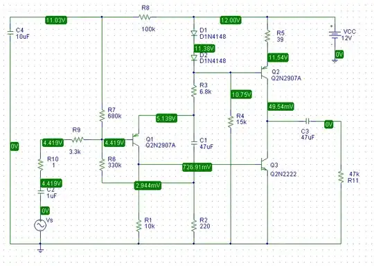

A workaround could be to load the Powerbank with 80-100mA to reset the shutdown-timer.
But in the circuit below would I change the 33ohm to 47 ohm that would put the load closer to 100mA.
33 Och (130mA) + LED (11mA) = 141mA load
47 Och (91mA) + LED (11mA) = 102mA load
Ref.: https://technoreview85.com/how-to-stop-a-power-bank-from-turning-off/ enter image description here

  • That's pretty close to our current design, I'm mostly wondering if PD is a "better" approach - one issue is that different batteries seem to have different sleep conditions so it's hard to come up with a one-size-fits-all design. – Jeff Dec 27 '22 at 19:49
  • Its a quick and dirty solution that is cheap and by varying rhe 33ohm resistor its adaptable. – MatsK Dec 28 '22 at 10:21
