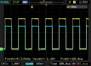

This works pretty much as desired, however I'm unable to measure anything shorter than around 49 cycles. The two scope images show the problem. The yellow trace is from the external oscillator, the blue trace is the pin toggle inside the interrupt handler. There is nothing in the main loop, and having things there doesn't change the results significantly. All the variables are uint8_t. Reading the count in high and low bytes gained a bit of speed (compared to a single 16 bit read/write).
The best I've been able to do is ~95kHz, but I'm curious as to where the lost cycles are going. The assignments can't be more than a few cycles each and if I understand right, ISR basically calls cli() on entry and sei() on exit, so the only thing that happens is the timer gets reset, the function returns and we wait for the next toggle.
Scope trace for low frequency

    No, there is a lot more going on in ISRs, you can see this by disasembling your code. Take a look [here](http://electronics.stackexchange.com/questions/64043/avr-interrupt-service-routine-not-executing-as-fast-as-expected-instruction-ove) help? – angelatlarge Apr 07 '13 at 06:08
  • Thanks, interesting read! I'll try writing a tight loop instead, see how that pans out. If possible I'll put scope results up for both so people can see the difference. – Josh Apr 07 '13 at 06:27
