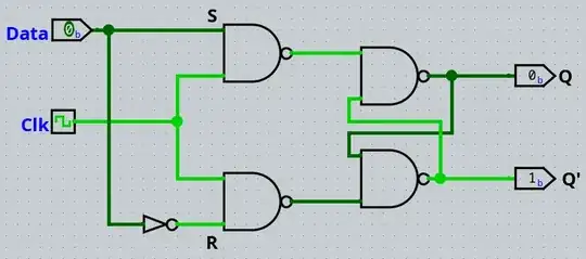

I have the following D flip-flop circuit: enter image description here
When I tested this in logisim, it seemed that the circuit was actually level-triggered, since when I slowed down the clock to 0.25Hz, and would change the value of Data while the clock was on high (but past the positive edge), the values of Q and Q' would still update, despite what I've been told about the edge-triggered nature of flip-flops.
I would call it a D latch. I would call a circuit a flip-flop if it is edge triggered rather than level triggered. However, your circuit is not edge triggered. It is level triggered.
it seemed that the circuit was actually level-triggered, since when I ... change[d] the value of Data while the clock was on high (but past the positive edge), the values of Q and Q' would still update.
That is correct. It is level "triggered". The "clock" in your circuit is really an "enable".

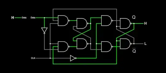

A second approach to making an edge triggered flip-flop is to use feedback in such a way that when the clock pulse arrives at the flip-flop, the data is latched, and then the internal state of the flip-flop quickly moves to a stable state in which data inputs have no effect. Flip-flops designed along these lines include circuits like this:
You may simulate this circuit interactively using this Falstad link
You will notice that in this circuit, there are actually 3 latches. And there is feedback into the 2 latches on the left hand side of the schematic. This feedback is used to "move" these latches into states where they are impervious to future input changes. Only when the clock becomes inactive again, do these latches regain the ability to respond to input changes.
