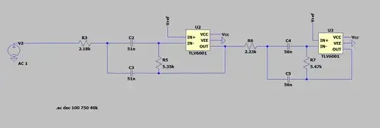

I want a band pass filter with center frequency 5.5Khz and a passband of 1kHz. I inserted that into a website and got the frequency response and the components to implement the filter:
I copied the circuit to LTSpice (with a different op amp):
And got this frequency response:
Why is it so different from the one shown at that website?

  • Is that a 50 Ohm load I see there? (Haven't even looked at the TLV6001, yet.) – jonk Dec 17 '22 at 16:20
  • You should not have R9, however I doubt that is the entire problem. I'm suspicious of the 55 and 56.2 ohm resistors, remove them from your simulation and see what happens. TLV6001 should have sufficient GBW for the centre frequency, but it might be marginal on Q. – Neil_UK Dec 17 '22 at 16:24
  • @jonk yes it is and i already tried to do a simulation without it – Scipio Dec 17 '22 at 16:31
  • What do you mean by: *So if i take the load* and, what do you mean by: *If i take the resistors connect to Vref*?? – Andy aka Dec 17 '22 at 17:06
  • @jonk i dont have the frequency expression, if i had i wouldn't use that filter calculator website. – Scipio Dec 17 '22 at 17:12
    You should not be taking out R4 and R8 _entirely_ -- they're there for a reason. However, since they are AC coupled to the op-amps, **you can bring them to ground**. The TLV6001 has an open-loop output impedance of \$2300 \Omega\$ and a GBW product of 1MHz -- so at the nominal 5.5kHz loop closure frequency they'll have an _inductive_ reactance of 12 to 13 ohms. With the not-much-higher impedances of R4 and R8, this will cause weird coupling between the stages, and won't quite be ground. – TimWescott Dec 17 '22 at 17:15
    Given the rated open-loop output impedance of that particular amplifier, it may be profitable to multiply all of your impedances by 10, or even 100 (i.e., increase the resistances by a factor of \$k\$, and decrease the capacitances by the same amount). Doing so may let you bring R4 and R8 to \$V_{ref}\$ without weird things happening -- or at least, with _less weird_ things happening. – TimWescott Dec 17 '22 at 17:17
An LTspice simulation of the circuit is very similar to the simulated results from the reference Web site. Perhaps the opamp models you are using are bad (model faulty, subcircuit(s) not constructed properly, ...). Many things can go wrong when importing 3rd party models. Have you tried a simple amplifier using the model you are using? If not, you need to do this to verify that the model is behaving as expected.
The following is a filter with a perfect Vref supply that is outlined with the red box. When doing SPICE simulations, go for the basics first, then add on the frills. I used one of the opamp models that comes with LTspice that I know works.
