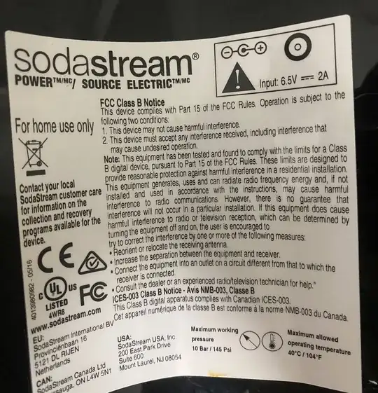

This is the specification plate on the machine:

  • The correct adapter has a 6.5V DC output.
    This is shown on the adapter and on the machine.
  • The adapter that you trued to use is rated at 19 V DC output.
    This is far higher than 6.5V and would be expected to cause damage.
I recommend that you ask a competent repairer to determine whether the machine is repairable.
