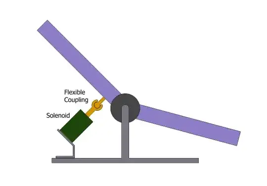

I need to find out if it is possible to make such toggle button to be used to turn on/off a load not bigger than 5 A at 12 VDC (car battery). Can a Z44N MOSFET handle this? Something similar to the picture, but able to handle more current.
