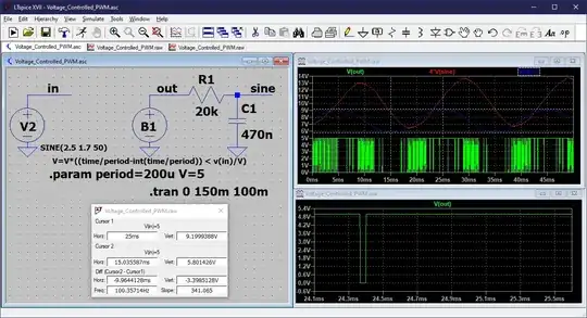

I had been trying to find a way to simulate a PWM signal for a sine wave, other than using a large and cumbersome PWL file, or using a comparator between a sine signal and a sawtooth for the carrier. So I found a post in the AllAboutCircuits forum that provided a voltage-to-PWM function:
https://forum.allaboutcircuits.com/threads/ltspice-take-voltage-and-convert-to-pwm.172663/
I modified it slightly to work with a sine wave, but I found that it did not provide the expected high and low duty cycles at the limits of the sine wave. It is not clear to me why this happens, and I'd like to find a way to get this to work over a wider range of duty cycles. Here are screenshots showing the effect of a slight increase of amplitude which is more than 1.65/2.5 = 66% and 33% duty cycle.
Sine wave PWM - no distortion
And with a little greater amplitude - distortion:
Sine wave PWM - distortion
As @Jonathan suggested, setting a maximum timestep of 100 ns works a treat. I was also able to use a 2 kHz carrier in place of 5 kHz and that also allowed up to 0% to 100% modulation. Even 1 us works, and simulation is much faster.
(edit) In the interest of completeness, here is a successful simulation at 100% modulation and 10 kHz carrier for 50 Hz:
Sine wave PWM - 50 Hz 100% modulation 10 kHz carrier

    LTSpice's automatic timestep selection might get confused since the function is not differentiable. Try setting a minimum timestep in your .tran command, i.e. 100ns. – Jonathan S. Dec 01 '22 at 00:40
    Yes, that does it. I was also able to use a carrier of 500 us period (2 kHz) for which I can get 0 to 100% modulation, and even a little more, before distortion. Thanks! You can put this as an answer which I will gladly accept. – PStechPaul Dec 01 '22 at 00:44

The problem here is that LTSpice is unable to differentiate the function of the PWM voltage source. Its differential is zero at any point in time except for those when it switches (at which it's undefined). This trips up LTSpice's automatic timestep calculation, which means that LTSpice advances the simulation too far at once.
The solution is to limit the maximum timestep in the simulation command. This directly influences the maximum PWM error (in the form of random jitter that can get as large as the maximum timestep).
