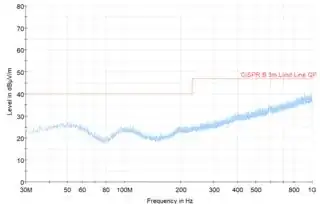

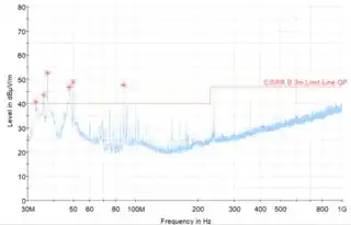

The product is a 5V USB powered, non-radio, 3v3 LDO regulated, 2 layer PCB inside a plastic enclosure. Here's the test report:
Failed emissions
Also attached the results when we disabled USB data transmission. Clearly the USB module is the cause of failure.
passing without USB module active

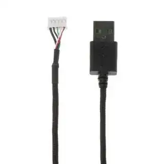

USB cable
I would like to have your feedback on hardware and firmware interventions that will help us pass next time.
Hardware
  1. Do you have any suggestions for a "better" cable/connector USB solution? Alternatively, do you think it's possible to custom order thousands of the current 2mm pitch cables but with extended shielding such that the data lines are unshielded for a shorter length? Most examples of cables terminated this way (by stranding out the 4 lines and the shield to a 5th line) have a similar length of opening from the isolation of the shield to the connector.

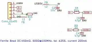

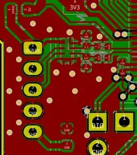

  2. Here’s the schematic of the current termination. The MCU pins are only 2cm away from the connector and we’ve placed several ground vias around the termination connecting to the bottom ground plane, much like explained in "In a 2 layer PCB with a top layer densely populated, from an EMI & EMC point of view should the ground plane be on top, bottom or both and why?".

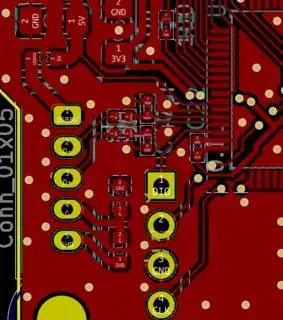

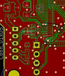

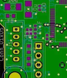

And the layout:
enter image description here enter image description here enter image description here
Are there any suggestions for improvement? I believe our problem is similar to "Radiated Emissions", to which an off the shelf filter is suggested as a solution. Would that be an external ferrite bead around the cable cord? Ideally we wish to get away with not using that.

EDIT - Updated Layout and test plan
Thank you all for the answers. I've taken everything into account and here's what I'll do:
  1. Have a couple of ferrite clamps at the next lab visit and find a way to prototype a custom shaped shielding can to be placed around the USB connector and be tied/shorted well to ground.
  2. Remove the FB from shield to ground and tie the shield to the ground plane through a 0 ohm resistor with less thermal relief on the pads. On the Vbus line I will change the FB to one with a 500mA current limit and 1k resistance @100Mhz. On the data lines I'll introduce ESD protection + common mode choke with the ECMF02-4CMX8. It has a 90 Ohm attenuation at 100MHz which I figure won't do much to reduce noise at 37 MHz, so I'll keep the RC filter that follows and increase the resistance to 100 Ohms for a ~33Mhz cutoff frequency. By probing the data lines on the oscilloscope I see a D+ and D- frequency of 6Mhz (I was expecting to see 12MHz given it's USB_FS), so I believe a cut-off of 5 times the data line frequency won't affect the eye diagram really badly.
  3. and 4) From what I gather, the system clock frequency in itself doesn't cause emissions, but rather contributes to emissions if noise is coupled to whatever can act as an antenna in the circuit. In my case the cable can act as an antenna, especially it being splayed unshielded for 1 cm prior to the USB connector. However there doesn't seem to be any obvious noise coupling from nearby traces so it is still not clear to me what to blame for the 50dBuV/m noise at 37MHz and 49MHz. I will assume it is the data transmission rate and ask my firmware colleagues to prepare a test code with a slower transmision rate for our next visit.
As for the answers I'll accept Tim's by popular demand although each answer really contributed to forming my next course of action.
updated layout:

  1. Unshielded cable.
    It might not be fully unshielded, but a few cm of unshielded length is enough to be a problem.
    USB over plain pin headers is generally a bad idea, and only reasonable where the immediate noise environment is quiet and shielded. These assemblies are commonly used inside PCs, where the metal enclosure provides such an environment. The connector shell must be grounded to the enclosure in that case.
  2. Bad ground: ferrite bead in GND/shield return path.
    This very specifically increases the AC voltage drop across the ground-return path. This is almost always bad.
    In particular, USB's J and K symbols are unbalanced, so drive the cable with full logic level high/low together. The displacement current drawn by the cable (Vcc/Zcm) flows through the ground-return impedance, creating a voltage drop, which is exactly the common mode voltage measured externally.
If ferrite beads are needed (say to dampen resonances on the cable, or to choke AC currents between the connector shell's chassis ground, and local circuit ground -- a common mode voltage which probably shouldn't exist in the first place, but may be tolerable given other mitigation), then it should almost certainly be around the whole cable, as a common-mode choke. Note that board-level components aren't very available (you'd need a 4+ line data type choke) so the cable bead is the preferred solution here.
Note that appnotes, and indeed real products, often put a ferrite bead on the ground-return path. This practice is even supported (in the sense just that you can find the schematic..) by the standard itself -- they do indeed suggest such an arrangement -- when suitable. As mentioned, such a case might be helpful with a metal enclosure. That's about it. It is very specifically a poor solution for simple plastic-enclosure devices.
Then, how do they get away with it?

    Based on the low frequency emissions I would bet money that the cable is radiating. I would definitely try slapping a ferrite on the cable to see if that can solve the problem. It may be possible to keep the ferrite hidden near the JST connector. I would also try replacing L1 with a 0 Ohm jumper to see if that helps. Sometimes that can help and sometimes it can hurt. – user57037 Nov 16 '22 at 03:57

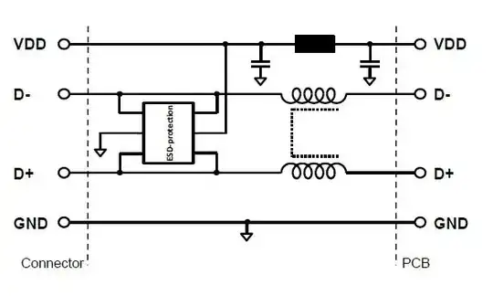

A common mode choke on D+ and D- is essential along with a 4 layer circuit board to keep any high frequency stuff confined to your PC board.
From reading discussion here I believe that you should drop your R/C type filters. Properly selected ferrite beads are far superior filters for this type of issue.

    Unfortunately, USB isn't very amenable to CM filtering. About the most you can get away with is a 100 ohm data-pair bead, which helps a bit for High Speed; the impedance is low enough not to corrupt the J/K symbols. More is acceptable for Full Speed-only operation, but not enough to deal with the full 30-100MHz harmonics shown here. Choking the whole cable, will do the job; but it might not be practical (big core with multiple turns!). Improved shielding is the best strategy here. – Tim Williams Nov 16 '22 at 20:14
Consider the shield pin to be the 0V reference for EMI purposes.
At low frequency, your GND is 0V and power is 5V.
At high frequency, your GND is -2.5V and power is +2.5V because of L1. Data will move in between them.
But at the other side of the cable (host), the GND pin is still at 0V and power at 5V, even at higher frequency.
That means the common-mode voltage of your board will constantly float around at high frequencies which are blocked effectively by L1. He detected it with an E field probe, not a magnetic probe, so the loop areas are not the main issue here.
I suspect that replacing L1 with a short will make it much much quieter. Only then, will you see potential further issues.

1 - I suggest you use an EMC filter. They are designed specifically for this situation (see image below).

  • 1.Isn't the EMC filter just an RC filter in the IC? I copied the valus from this https://www.st.com/en/protections-and-emi-filters/emif02-usb01f2.html. TVS diodes won't be required because there's no exposed metal connection. 2. Could you elaborate on what I am looking to find once I find those datasheets. For example the bead specifications are written on the schematic, is that helpful? – Geo Nov 15 '22 at 16:48
  • There are many different types of filters. Low pass, high pass etc. You already know which frequencies are causing problems, you need to design (or tune) the filter to perform better at those frequencies. – glasshouse1991 Nov 15 '22 at 20:36
