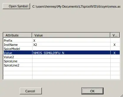

With the standard PMOS and NMOS symbols it works fine. What exactly were you unable to do with it?
schematic pmos nmos
