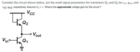

For the problem below enter image description here the value of \$i_{B2}\$ is ignored and is assumed that \$i_{C2}\approx i_{E2}\$. Shouldn't this only be applicable when \$\beta\$ is a big value so that the value of \$\frac{1}{\beta}I_C\$ can be neglected?

  • In the last exercise, you do not need to worry about DC conditions. Your job is to "build" a small-signal model and solve for a voltage gain. – G36 Nov 09 '22 at 16:26

Also, the problem below is using the small-signal model to calculate the gain. But why is the answersheet calculating \$V_{_\text{BE}}\$ using the exponential model \$V_{_\text{BE}}=V_T\ln\left(\frac{I_{\text{C}}}{I_{\text{S}}}\right)\$ rather than assuming its value.
Note that the problem specifies a very low power supply rail magnitude and also a power budget, too. This makes it more important that you work out the details more closely. The collector current may be impacted by changes in \$V_{_\text{BE}}\$ because those changes, even if only on the order of, say, \$\pm 50\:\text{mV}\$, may impact the base current enough to matter elsewhere.
This isn't a good design example, though. It's only useful by itself as an educational 'make work' example to test your mastery. Grounded emitter BJTs, and especially so when working with low voltages like that, must include follow-on stages and negative feedback for both DC biasing as well as for mitigating AC signal distortion. So, it's just make-work.

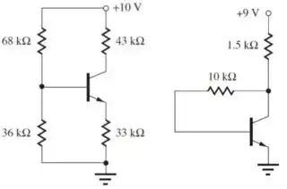

In your final sub-question to this question (geez, you just keep piling them on), note that the voltage rails are a lot higher now (\$10\:\text{V}\$ and \$9\:\text{V}\$) and that both of these are using very stiff biasing techniques where variations of base current will almost certainly have little or no impact.
On the left, the emitter is biased almost up to \$3\:\text{V}\$, which is very much larger than the assumed base-emitter voltage. Slight variations in \$V_{_\text{BE}}\$ will have only a small impact on the emitter's DC bias point. So the assumption is fine in this case. You could take an extra step to refine it, I suppose. But it wouldn't make a lot of difference.
You actually should take the time to prove what I just wrote about the left side schematic to your own satisfaction, though.
And then do that for the right side schematic. (Leaving that for you to try out -- I'm sure you are capable of it.)

Quote: On the other hand, for all problems for the two resistor bias network and the four reistor bias network like below, I never saw VBE being calculated. Every problem assumed it to be 0.7V.
In practice, for designing a gain stage with a required quiescent DC current Ic the corresponding value for Vbe cannot be calculated. This is due to the very large tolerances/uncertainties of the BJT parameters.
However, in both circuits shown by you we have DC negative feedback:
(a) Current-controlled voltage feedback (your diagram, left circuit) and
(b) Voltage -controlled current feedback (right circuit).
One of the advantages of negative feedback is a remarkable reduction of the sensitivity of the bias point to parameter tolerances of the active device. For this reason, it does not matter too much if you assume Vbe=0.6V or Vbe=0.7V. The difference in Ic is relatively small.
See the upper part of the enclosed diagram. Verify the case without feedback (RE=0) - the vertical broken line.
