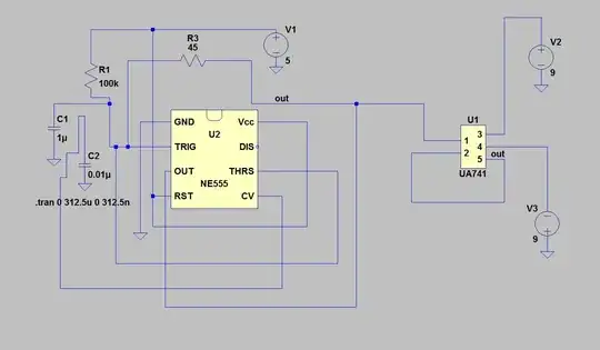

Here is my circuit in LTSpice:
Image of circuit added

    Show your schematic what you are trying to get working. It might have important differences with the schematic you have based your circuit on. – Justme Nov 06 '22 at 13:43
  • Hello everyone, thanks for taking the time to help me. I've added an image of the circuit I used last. There are already some problems with the input voltage - since it does not range from 0V to 30mV when connected to the opamp and the output is not amplified but just shifted upwards. – ulix Nov 06 '22 at 14:17

There is PSpice model on TI site link, you can download model here and "adapt it" to LTspice (trust me, it's easy). Please show your circuit, because it's unclear why you don't have any amplification (since circuits shown in link should be working properly).
Edit: Issue you have is probably due to high frequency components of input signal (you can watch FFT of that signal in LTspice, first maximum at ~40MHz), which this op-amp can't handle (zero amplification frequency is ~25MHz). And output signal you have is just offset voltage multiplied by gain (causes constant voltage ~1V and low oscillations of input signal).
