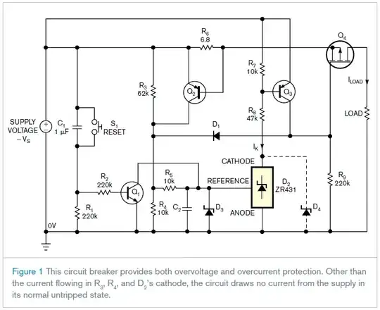

There are chips that do provide for functions of over voltage detect or over current detect. It can be quite inexpensive to build your own circuit though. There is a reasonably good article in EDN online which describes a discrete component circuit as shown below:
A neat feature of the above circuit is that it operates like a circuit breaker and removes the load from the faulted input. It stays removed until reset via a tact switch or the input power is removed.
It is my suggestion that the reverse polarity protection can best be provided via a series Schottky diode in the Vin+ supply line. I also suggest that you design your over voltage detector and over current detector in a manner that leaves the GND of the circuit intact. Someday when your project ideas turn into a real product that you must take off to a lab for emissions and immunity testing you will really appreciate using design techniques that keep a single GND, GND planes and chassis/enclosure references.
