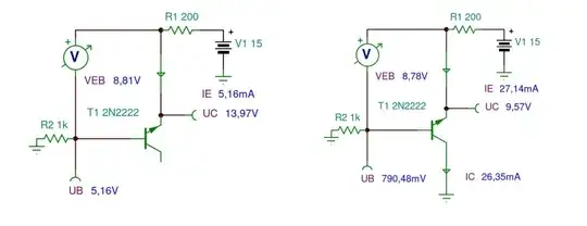

As I checked the transistor, it works fine up to 15 as VCC, but after that, the transistor gets turned on, and it starts burning at 22V.
I made simulations and some measurements with a real 2N2222 transistor.
Then let's see what happens at 15 V VCC voltage. If we do not connect the collector, it will be an 8.8 V Zener diode. By connecting the collector, it becomes a reverse-biased transistor, but it can handle the 25 mA collector current indefinitely (250 mW). It's getting a little warm. enter image description here
At a supply voltage of 24 V, the Zener current increases to 12.5 mA, but this does not destroy the transistor. It works continuously and gets a little warm. When we connect the collector here, the transistor still works, only the higher collector current heats up the transistor very quickly. It will last a few seconds until we can measure currents. If it is turned off in time, the transistor remains functional. After about 10 seconds it overheats and breaks down (700 mW). enter image description here
The actual measured values were: UB = 980 mV, IC = 86 mA.
I sometimes use reverse biased base-emitter junction as a low capacitance 9 V Zener if I need one. (For the simulation, I modified the transistor, connected a diode and a Zener between the base and emitter.)
