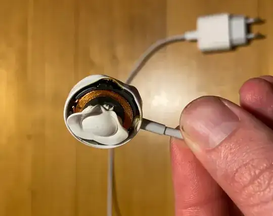

I got home today and immediately smelled burnt plastic. I discovered that an Apple Watch charger burned and melted (every part of the charger is original Apple.) See included photos: https://drive.google.com/drive/folders/1-AcoRIJWUrK5-6K8D8SvSjShFXAElYpv
I came up with only two possible options:
  1. Manufacturing error (too simple.)
  2. There’s a drawer right underneath where the Apple Watch charger was. In the drawer there’s an old unplugged wireless charging pad. The Apple charger was facing down with the coil and was right above the old pad. The separation was 3cm of hardwood.
Would it be possible that the Apple wireless charger started charging because it detected the coils of the old charging pad underneath and eventually melted down?

Not likely at all.
The chargers have foreign object detection to prevent heating of random metal objects nearby. Also the thing that would have been heated would be the pad, not the watch charger.
The watch charger also has overload protection built in. So a failure in the watch charger is the most likely explanation.
You should bring the watch charger to Apple, they should be very interested in doing a failure analysis on it.

I dont think it was charging the other wireless pad:
  1. It's too far: 3cm of wood + few centimetres of the air gap
  2. The coil of the charging pad would be Open. So, the charger wouldn't be able to detect it.
manufacturing error (too simple)
For how long did you have it? Have you left it in the sun too much? Was it stored near a heat source?
If you're no longer under warranty, you can open it up and see if the windings of the coil have a short somewhere? The insulation of the coper wires might have broken. But then, there should have been a current limiting function that should have opened the coil circuit.
