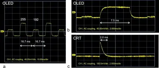

Did you know AMOLED generally has more motion blur than a 120Hz+ gaming LCD?
A high-refresh-rate OLED is extremely challenging, but not impossible. Several OLED's have actually reported to have a motion blur issue -- The big problem is the switching speed of transistors in an AMOLED. You only have a very ultra-brief time (typically under a microsecond) to trigger a transistor in an AMOLED screen, so the transitor switching speed is really slow.
If you plan to subdivide an OLED into multiple segments to refresh different parts of an OLED simultaneously, subdivide your OLED into vertical strips, and scan each segment in sync with each other. Otherwise, you get potential multiscan artifacts that can show up as stationary tearlines (this was common problem in old dual-scan LCD's of the 1990's; they showed a stationary tearline in the middle of the screen during horizontal motion).
Motion tests such as TestUFO will be a big benefit to your testing.
One way to do 1000fps on OLED is to use a PMOLED screen, but you will lose a lot of brightness (you need OLED pixels thousands of times brighter to compensate for the long dark periods between flickers). You will, however get excellent motion resolution.

    UPDATE: Since I posted this message, Oculus has released Development Kit 2 VR goggles (aka DK2) with a rolling-scan OLED with only ~2ms persistence. The low-persistence via a rolling scan, is a form of black frame insertion, and presents a more realistic technological option than ultrahigh framerate. 2ms persistence is achievable via black frame insertion (each frame visible for 2ms, with remaining time between frames black) or by using full persistence of 2ms which requires 500fps@500Hz (each unique frame visible for 2ms), both equivalent amount of motion blur in eye-tracked situations. – Mark Rejhon Jul 14 '14 at 19:10
I'd like to follow up with two new "Ultra High Hz" developments. I now have a peer-reviewed conference paper and presentation on a new display motion blur testing technique.
(1) I have received a prototype 480 Hz LCD display and, the difference is indeed visible to human eye. Here are my test results of 480 Hz (via Blur Busters).
(2) I may have figured out a way to potentially achieve higher refresh rates on an OLED. It is very OLED panel wiring dependent, but the thread is here in the Display Science, Research & Engineering Forum
Some example images include a 2-channel rolling scan OLED that has an "ON" scan pass and "OFF" scan pass -- to intentionally pulse the OLED (like a CRT) to reduce motion blur. This is what Sony Trimasters and Dell U3017Q does.
OLED rolling scan
This could in theory be used with concurrent scan windows for artifact-free ultra high-refresh-rates -- depending on how many channels the OLED has.
