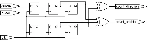

The technical publication "Accurate Quadrature Encoder Decoding Using Programmable Logic" by Yassen Gorbounov illustrates this problem and solves it using externally clocked programmable Logic.
The externally clocked solution suffers from the clocking delay and high energy consumption because its internal logic elements (gates, transistors) need to be constantly subjected to an external clock waveform (4x higher than the maximum encoder's output frequency). On the other hand, static signals almost do not cause any power dissipation in contemporary MOS circuits. The external clocking also adds the cost and complexity of a clock generator and its associated logic elements.

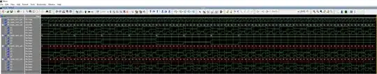

Your example circuit uses delays on A and B. The A and B signals clock flip-flops, then self-reset a short time later. The clock-to-Q + logic turnaround + reset time is the delay, which produces a pulse. This pulse gets fed to either the ‘forward’ or ‘reverse’ OR4 gates to produce 'count up' and 'count down' pulses. Finally, the count pulses set an S-R latch to show direction.
So it works. But, there are issues. And, it could be simpler.
First, the clock-then-reset pulse scheme is really, really sketchy. It’s a glitch generator that's neither consistent or reliable. It's entirely dependent on the internal speed of the flop and the feedback gates, and could thus vary considerably with process, voltage and temperature.
Second, the circuit is pretty inefficient overall. There's lots of unnecessary gates and flops that could be done away with (as we'll see later in the BONUS section below.)
Third, it has an outright bug: if the Direction flop is set to the wrong state, it can fail to control the resets properly, resulting in erratic behavior on the count pulses and Direction bit.
Picking this design apart further, I realize that there's redundant logic for that flop reset stuff. There is no need to select which output is doing the resetting based on the direction state; we can always just reset the flop. What they did there serves to add two gate delays from clock-Q to reset pulse, which while helpful, misses the point.
Here is a version that simplifies all that, while showing more clearly what they're doing (simulate it here):
When you analyze the flop behavior, you'll see they're being fired off on every edge they're set up to detect and being reset afterward, every time. And only one fires at a time. Knowing that, we can take out some redundant stuff.
Like what? The pulse commutation is done with a demux instead of gates. I did this for clarity, but it also is smaller (fewer transistors).
Each flop has mux on its reset line, which was unnecessary. Instead we take the Q output, insert a delay (3ns) that replaces the output gating (demux) and deleted mux delays (3 gate delays total), and use that to reset the flop. Side benefit: no feedback state issues.
Simulation note: as near as I can determine, Falstad models its digital elements with a default 1ns delay. So the resulting pulse should be T(clock-q) + 3ns + T(rst-q), or 5ns.
