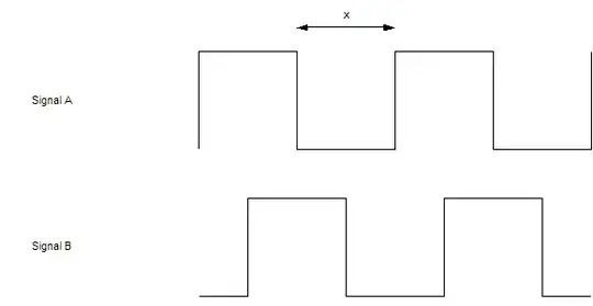

There are a couple of issues:
  • Not all AVR commands take 1 clock to be executed: if you look at the back of the datasheet, it has the number of clocks it takes for each instruction to be executed. So, for example AND is a one-clock instruction, MUL (multiply) takes two clocks, while LPM (load program memory) is three, and CALL is 4. So, with respect to the instruction execution, it really depends on the instruction.
  • 5 clocks to jump in and 5 clocks to return can be misleading. If you look at your disassembled code, you will find that in addition to the jump and RETI instructions, the compiler adds all sorts of other code, which also takes time. For instance you might need local variables which are created on the stack and must be popped off, etc. The best thing to do to see what's actually going on is to look at the disassembly.
  • Lastly, remember that while you are in your ISR routine, your interrupts are not triggering. This means that you will not be able to get the kind of performance you are looking for from your logic analyzer, unless you know that your signal levels change at intervals longer than it takes to service your interrupt. To be clear, once you calculate the time it takes for your ISR to execute, this gives you an upper limit of how quickly you can capture one signal. If you need to capture two signals, then you start runnning into trouble. To be overly detailed about this consider the following scenario:
If x is the time it takes to service your interrupt, then signal B will never be captured.
