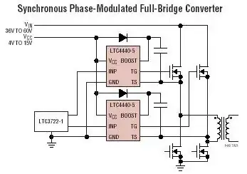

"Shoot-through" is a name given to the simultaneous or over-lapping conduction of both MOSFETs in a half-bridge circuit. To avoid this we leave several tens of nanoseconds gap between deactivating the lower MOSFET and activating the upper MOSFET then, perform the same ritual when deactivating the upper MOSFET and re-activating the lower MOSFET for each half-bridge.
Of course, this is made easy by buying/using MOSFET drivers that have anti-shoot-through circuits built in like this: -
However, your MOSFET drivers don't have anti-shoot-through avoidance circuits and, you appear to be driving both MOSFETS without any care in this respect. This will produce large surge currents in your power supply.
Image taken from here and here.
