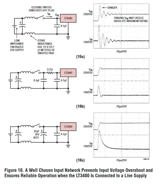

What Adafruit is recommending is powering up the supply, then plugging in the circuit? In other words, hot plugging.
A few years back we did a hot plugging test, powering up a 28 VDC supply then plugging the connector into a circuit. At the input of the circuit we saw spikes of more than 60 V. This was after we had removed the TVS diode on the power line.
The Linear Technology LT3480 DC to DC converter data sheet has a nice illustration of how hot plugging, cable inductance, and load capacitance work together to form a tank circuit, and ways to mitigate it:
Examples of input voltage overshoot from LT3480 data sheet
I've seen overshoots on the order of 10 %, if you plug in the circuit first, then turn the DC supply (what Adafruit tells you not to do). I suspect it might be tanking as well, but because the supply takes time to power up, it limits rise time of the voltage, and thus reduces the amplitude of the spike.

Sorry I didn't fully answer your question. If the spiking behavior that Adafruit is referring to is tanking, then the problem should be independent of supply type (linear or switching) or quality of the supply. The length of the leads and the output impedance of the supply would have a large influence on the spike amplitude. A supply with a separate output switch would have worse spiking problems, assuming the switch allowed voltage to rise quickly.

    Isn't this due to heavy use of MLCC capacitors for supply decoupling? (Low ESR, and highly non-linear causing peaks over 2x the input voltage.) – Oskar Skog Oct 25 '22 at 16:59
  • @Oskar Skog You are correct, in the 60 V example, we had a buck converter with about 10 uF of capacitance at it's input. In a different case, we had a supply that was always powered, a switch, and our circuit. Part of our circuit was a current limiting circuit (LTC4364) that controlled a mosfet. When the supply first turned on, we thought there should be no spiking since we no outward facing capacitance (the mosfet starts in an off state), but we were wrong. The turn on time of the switch was very fast, and current was jumping across the capacitance of the mosfet. Again, capacitance. :( – C. Dunn Oct 26 '22 at 21:22
