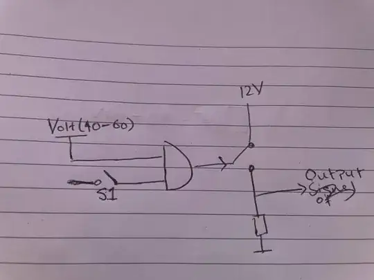

I would like to implement the following logic:
Whilst the switch S1 is pressed AND there is a voltage on VOLT (this would range from 40-60V) then the output switch would be closed and output would be at 12V. Otherwise the output is pulled to ground. I have drawn the AND gate purely to explain the logic. S1 is floating as it could be tied to ground or anything else that may be more suitable.
What would be a good way of implementing this? I considered using a pnp bjt but the variation on Volt would have made it fairly tricky to implement.
The output signal for a logic high must be between 11-13V. Does not have to be 12V. It just so happens that i have access to a 12V line.
Would something like the following work (Apologies but VBAT here is VOLT(40-60V)?:

  • What if the voltage is 39 volts? <-- what do you want to happen? What happens if it's 39.999 volts or over 60 volts? You can attach 12 volts to the output of an op-amp. What is VBAT? Your 2nd picture appears to show the threshold being at 12 volts rather than 40 volts. Why can't you put the switch in series with the comparator output and get rid of the PNP transistor? – Andy aka Oct 24 '22 at 19:56
  • No need for the pnp. Wasn't thinking straight. switch in series makes sense. I suppose the voltage source itself ranges from 40-60V. It would make sense for the threshold to be no more than 25% lower so say 30V). So yes that circuit is completely wrong. – Hasman404 Oct 24 '22 at 20:16
