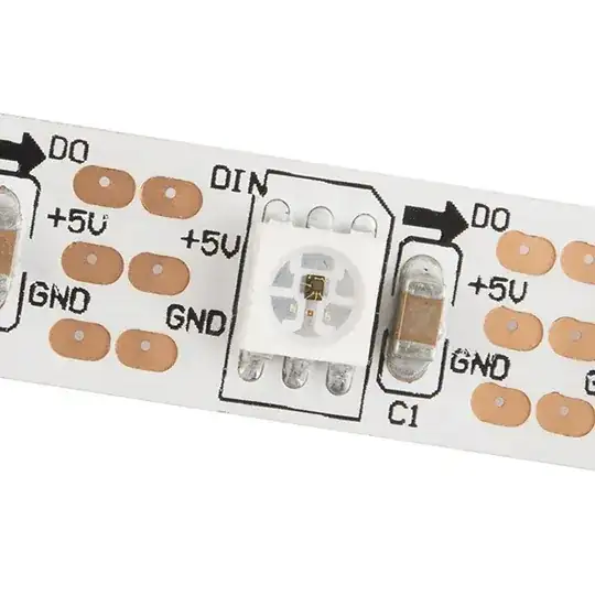

I'd like to know what is the name of the connectors in those devices. I'm trying to create a sensor for myself, and I think they are very practical when trying to add cables or clincher connectors.
The pins are 0.1" apart

These are sometimes called solder tabs, they are crimped and/or soldered. An example is 1-88997-2. Here is a page containing multiple options
This image may be a good reference:
View the source, it may be interesting for your applicaton
Crimping may require an expensive tool, but if you plan on mass production, it may be a cheaper process than soldering. You might find a manufacturer to crimp and/or solder it for you.

  • Thank you for your input. I think those are called crimp Pin tins? I didn't know you could crimp them in a flexible pcb though. The crimping tool is expensive but not prohibitive. – Michael Efraimidis Oct 24 '22 at 14:14
