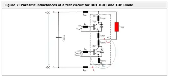

And I came across the following lines talking about the effect of the gate inductance on the Eon Switching losses:
Here is the circuit (Figure 7)
Here are their measures:
If I correctly understand, it is said that the higher the inductance is, the lower the Eon would be, where Eon are the energy loss for turning on the IGBT.
Well, from my mind, a higher inductance will limit the rise of the gate to source voltage, and it will slow down the commutation of the IGBT and so the losses would be higher.
I am not sur to understand what SEMIKRON is saying: "The effect of this inductance can be compared with a current source, which supplies additional gate charge at the beginning of the "Vge-plateau" period."
I think that as at the beginning of the turn on process the current is maximal and limited by the driver, the inductor is magnetically charged and when the miller plateau arises, the inductance is still a bit charged and so the inductance tends to reduce in time the Miller plateau. But clearly, I do not think that it is as simple as it.
Do you understand why a higher inductance on the gate reduces the Eon?

Remember that turning "on" the gate requires charge.
If there were no inductance on the gate signal, the gate would initially appear as a capacitor, and the gate charge rate would be determined by the gate voltage until the Vge plateau period, which occurs when the gate voltage reaches the gate voltage threshold. This plateau occurs when the reverse transfer capacitance (a capacitance between the collector and the gate) starts to affect the charging rate. As the collector voltage goes rapidly negative, this collector-to-gate capacitance tends to drive the gate voltage more negative, so the gate voltage and charging current is reduced (or sometimes reversed if the gate drive impedance is high enough.) This is the cause of the "Vge plateau." During a switch, the negative feedback effect of this phenomenon causes the gate voltage to rise until switching starts, then remain at a more or less constant level while the collector voltage drops, then rises again. Hence the "plateau."
The introduction of the inductance on the gate input has a tendency to counteract this. While the external inductance causes a longer delay to reach the threshold voltage, when the threshold voltage is reached, the gate charging current flowing in the inductor has a tendency to remain constant, regardless of the drive voltage. You can see this occurring in Vce in figure 10: with the lower inductance, Vce starts to switch 40ns sooner, but with the higher inductance the plateau effect on Vce is less pronounced. The "current source" contribution adds to the charging from Vge voltage, making Vge appear lower when measured from drive before the inductive, external traces.
Since the device switching time is reduced, Eon is also reduced - in the same manner that it would be if a higher-voltage, higher current gate driver were used. It's not clear to me why this is presented in this way, unless just to demonstrate the potential effects of parasitic inductance on the switching and reverse recovery.

  • Thank you for your answer. I do not get what you are saying... Can you please add some visuals ? Also on which circuit the collector voltaage goes negative ? – Jess Oct 25 '22 at 07:11
  • Before you start to switch, the collector is at 750 volts. Then when you switch the collector rapidly goes negative until it reaches Vsat, usually a few tenths of a volt. – John Birckhead Oct 26 '22 at 18:33
  • In a boost converter working in CCM the collector voltage does not go negative as the diode is still conducting until the total current is not flowing through the IGBT and Vout is not negative. – Jess Oct 27 '22 at 06:26
  • A boost converter is a good analogy. When the drive voltage VGon is applied, the inductor Lg stores energy - energy that would otherwise have charged the gate capacitance. Hence it takes longer to get to the threshold voltage and start to switch. Once the plateau is reached, the inductor gives up some of this energy, pushing through the plateau more quickly. The authors are not suggesting use of inductance to reduce Eon, only describing the effect. Adding inductance would increase the requirement for dead time and losses associated with the off delay time, so there is no free lunch here. – John Birckhead Oct 27 '22 at 12:40
