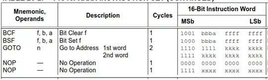

From datasheet, we see that each is a single instruction cycle except the GOTO, which is 2.
So you'd expect exactly what you're seeing: 20 MHz clock gives 5 MHz instruction cycles; you have a 5-cycle loop; hence 1 us period.
