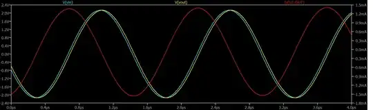

TLE2144-q639414
No visible distortion at all. You may become interested in output current:
TLE2144-q639414-current
Finally, the .ac analysis simulation run
TLE2144-q639414-ac(fig-15)
gives an \$A_{VD}\$-vs-frequency plot, exactly representing the graph of Figure 15 of the datasheet. The inductor in the opamp feedback is only a technical trick used for the .ac analysis, permits to compute the DC operating point, helps avoid the opamp being sticked to the rail voltage, and has no meaning for the real device operation.

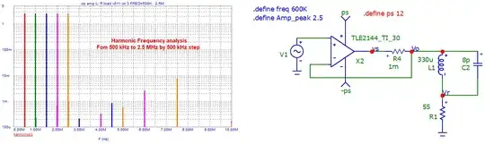

Using a voltage follower with TLE2144, I was able to get an output of 4.5 Vpp with an input from the function generator, but after it reaches above 510 kHz, the signal starts to distort on the negative cycle.
Unless a "wiring" problem on test board ...
Don't know if this can help, but my simulation does not show distortion until 700 kHz is reached with a peak-to-peak voltage output of 20 V (as OP third graph shows).
Don't know where the "bug" is?
For ~ 5 Vpp, frequency should be 2.5 MHz (?).
