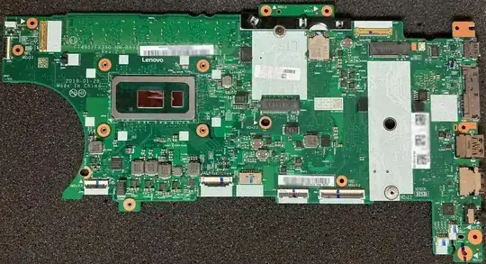

As to why this may work well enough in a laptop or computer but not in your design, my guess would be higher capacitance. Both laptops and computer motherboards contain 4-10 layers, and the connector may be far away from the processor directly, meaning that the trace capacitance is not insignificant.
Here are two photos, one where the connector is close and the other where it is far. It may be that this SSD will work in one laptop but not in the other. photo of a laptop motherboard with close SSD source
Photo of laptop motherboard with far away SSD source
