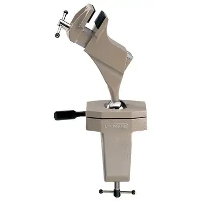

Like others have said: use a clamping vice. I use a Bernstein Spannfix:
Bernstein Spannfix
It won't help to keep the PCB cool, but at least you won't burn your fingers.
The seemingly hot PCB is not really a problem. A PCB which is at 60°C may be too hot to touch, but during reflow soldering the whole PCB is exposed to temperatures close to and above 200°C for minutes. This way much more thermal energy is applied than you can with a hand soldering iron.
