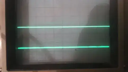

I’ve probed around the board for strange behavior, and I think there might be something wrong with the crystal oscillator, based on what the oscillator signal looks like on the oscilloscope:
This event happens once, on powering the board, and after this event the oscillator signal is completely dead.

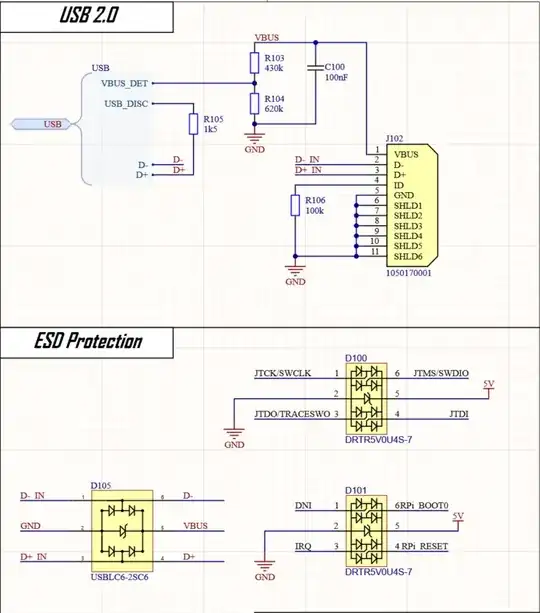

EDIT: Since several people pointed out that the crystal is not what's giving me errors here, and someone requested the schematics, I've included the full MCU schematic below. What I'm specifically trying to solve is that my software engineers tell me that the bootloader should load automatically and if the MCU is working it should pop up as a USB device when I connect a cable from my PC to the USB connector on the PCB, which is connected to the USB pins on the STM32. But it doesn't pop up as a USB device, and I can see no activity on the D+/D- pins of the USB bus. I'm far from an embedded wizard, so I've for now opted on trusting the SW people, and I'm working with the assumption that there's a hardware error here.
Here's the MCU schematic, MCU Power schematic and the USB connector implementation, which should be working (if the software engineers are correct in that the STM32 should pop up as a USB device out-of-the-box). Also, I've already realized that the debugging LEDs on the MCU schematic have been implemented wrong, silly mistake by me.
MCU:
MCU Power:
USB Connection:

  • Oscilloscope shows some "fuzz" (not oscillations), but perhaps some clock activity nearby. Could the MCU be using internal clk source? It appears that for a short timespan, this oscillator is enabled, and rising to its bias level near half the supply voltage - oscillations should start soon after...but it is shut down before that happens. – glen_geek Oct 01 '22 at 12:32
  • You are 100% guaranteed barking up the wrong tree here. As Justme points out, the HSE oscillator only starts up when commanded to by code - the MCU boots up using its HSI. Show us the rest of the MCU pin connections - in particular power supply, JTAG, Reset, BOOT pin(s), etc. – brhans Oct 01 '22 at 13:08

  • The bootloader is not running, and the software engineers are saying that it should start running the bootloader without any programming. We've not loaded any softare to it as we haven't been able to communicate with the MCU. – Lars Petersson Oct 01 '22 at 12:31
    @LarsPetersson You should not trust what they say. Ask how they try to start the bootloader, but it needs to be triggered in certain ways. JTAG and SWD will work without bootloader starting, but if that does not work then there is a hardware problem. – Justme Oct 01 '22 at 12:41
  • Ok, makes sense. I'll question what they're telling me on monday. Thanks!! – Lars Petersson Oct 01 '22 at 12:51
    @LarsPetersson: You need AN2606: https://www.st.com/resource/en/application_note/cd00167594-stm32-microcontroller-system-memory-boot-mode-stmicroelectronics.pdf – Tom V Oct 01 '22 at 20:02
  • This was completely right! I just hadn't done my homework on reading on how an STM32 MCU works, and trusted my software people. See my last edit on the post on what resolved the issue. Thanks all for the help! – Lars Petersson Oct 03 '22 at 15:32
