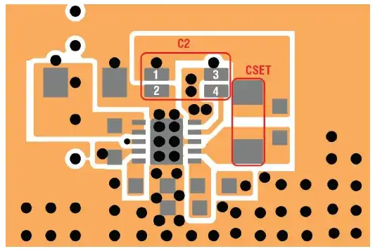

Let's look at a more complex example, this time using the ultra-low-noise, ultra-high-PSRR LT3024 LDO. The evaluation board has the following layout1:
I can reproduce this in EAGLE, but it's such a pain that I find myself wishing I could just do this2 instead (this is my mockup, and my reference designators match those of the evaluation board):
So just how much am I sacrificing if I choose to be lazy and use traces instead of polygons? If I have a relatively low-frequency, low-current (< 200 mA in the LT3024 example) circuit, does it really matter? Why, or why not?

Lots of application-specific reasons but in your example, the big driver is thermal considerations. From the datasheet:
For surface mount devices, heat sinking is accomplished by using the heat spreading capabilities of the PCB and its copper traces. Copper board stiffeners and plated through- holes can also be used to spread the heat generated by the regulator.
And:
The undersides of the DFN and MSOP packages have exposed metal from the lead frame to the die attachment. Both packages allow heat to directly transfer from the die junction to the PCB metal to limit maximum operating junction temperature.
That's why you have a big polygon with a lot of vias in it under the package. For the input and output pins, the datasheet doesn't have any special notes on it, though some do. 200mA is small enough that you wouldn't have to do anything special with trace width in terms of current carrying, but connections to filtering or decoupling capacitors should be low-impedance. Increasing trace width lowers the impedance, which is also why I suspect SET has a polygon on it. Of course, polygons generally have variable effective width as you traverse them so the resulting variations in impedance may not be desirable.
In general, I would start by looking very closely at the datasheet for whichever part is in question. Your LT3042 has a note to look at the DC2246B's datasheet for layout details, which is where you can see the split capacitor layout for C2. Then, I would see if any of the big manufacturers have white papers or app notes regarding layout of the type of component. For example, there's lots of generally-applicable information about switching regulators which are arguably much more picky about which polygons go where.
