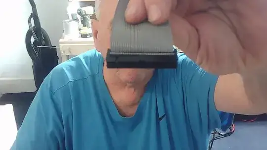

  1. Photo attached IDC connector

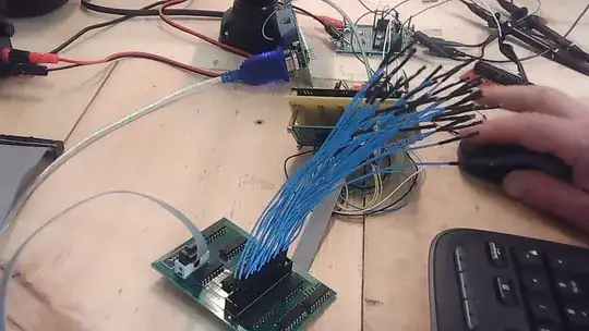

FURTHER UPDATE: Instead of a ribbon cable, I attached 34 jumpers to the header. Lo, and behold, I can provoke the resets by wiggling those jumpers. That suggests that my problem lies in the way the header is connected to the board. Instead of tying some of the header pins to interior layers for power and ground, perhaps I should have used surface traces?jumpers replacing ribbon cable

  • Can you add a photo of the IDC part of the connector? – Anas Malas Sep 26 '22 at 12:31

  • @WalterOney - Hi, While we do encourage OPs to update their question, as they discover more details, you seem to be adding details but leaving now-disproved details, which can mislead readers e.g. the title is "Short circuit in ribbon cable" but you've removed the ribbon cable & the resets still happen. I recommend you go through and update *all* info to the latest state of knowledge. (There is an edit history, but I would also add a section at the bottom saying that short circuits in the cable were an initial suspect, but this was disproved by your test replacing cable with jumper wires). – SamGibson Sep 26 '22 at 17:48
  • @WalterOney - Are you able to add the schematic for the board(s)? Are you able to answer the earlier comment from *Lundin* regarding investigating the reset reason logged by the MCU (obviously you'll need to write code to do that and output the result)? Given that you can provoke the problem with those jumper wires attached, have you tried to minimise the test case i.e. remove all possible wires but still trigger the problem? Which wires (connected to which signals) are absolutely required for you to trigger the problem? Then IMHO we'd need the schematic & close-up photos of the board. – SamGibson Sep 26 '22 at 17:54
