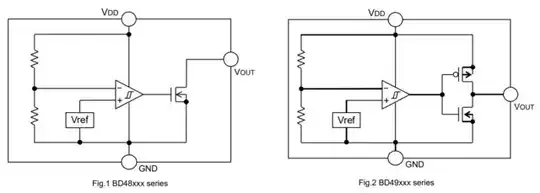

The TPS63020 has an EN enable input pin, active high as it's naming suggests.
This can be driven by just a small and cheap voltage monitor IC in a 3-pin or 5-pin package.
There are a great many different parts on the market that you can select from a supplier.

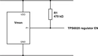

An example is the Rohm BD4931G, a voltage monitor with a 3.1 V ±1% threshold costing something like 40p. When the supply rail is below 3.1 V ±1% its output will drive low, otherwise it is driven high. This part comes from two families, one with open-drain outputs and the other with push-pull, as shown below (modified datasheet diagram).
The BD4931G consumes 0.9 uA typ. and operates correctly down to a 0.95 V supply. The TPS63020 regulator can operate from a 1.5 V supply, so the voltage monitor will reliably cover the full circuit operating range.
Unless you are happy with a delayed switch-on, ensure that you select a voltage monitor rather than a power supply supervisor that delays its output switch-off to generate a reset pulse.
The addition to the TPS63020 circuit is then as shown below. R1 allows an open-drain part to be fitted as well as a push-pull, allowing a wider range of usable parts.
