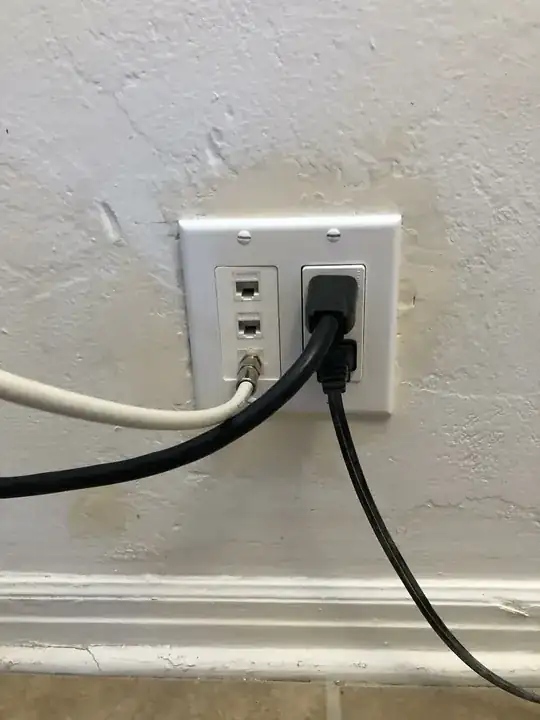

I set up my first electrical box on this project, then I realized that there's the possibility for inductance within the electrical box between the 120 V wires to the outlet and the Ethernet cables. I looped each cable in the box once to provide 6" of slack to allow enough room to connect everything as suggested here.
Image shows double wide electrical cover with a 110 V, 15 A outlet on the right slot and two Ethernet ports and a coax cable, arranged vertically, on the left slot
The top outlet is connected directly to the circuit, whereas the bottom outlet is for a light and is interrupted by a switch on the door.
Because I am concerned about an inductive relationship between the power lines and the Ethernet lines, I measured the voltage between the pins of the Ethernet cable and ground and found that the maximum voltage detected was 3 VAC @ 60 Hz.
Image shows digital multi-meter testing double wide electrical cover, with negative probe inserted into ground hole on the outlet on the right side and with positive probe inserted into pin on the Ethernet port on the left side. The multi-meter shows an alternating current voltage of 3.105 volts on the display.
The light consumes 21 W of power on its max setting, so at 120 V that would be 0.175 A. To explore the relationship between current and voltage between the pins and ground, the following table is presented.
Setting Wattage (of light) Measured voltage (between Ethernet pin and ground)
switch off / light off 0 0.3 V
switch on / light off 0 2.584 V
1 7 W 2.629 V
2 15 W 2.630 V
3 21 W 2.748 V
Observe that the dominant influence on voltage between Ethernet pins and ground is dependent on the presence of voltage, and not current, in the power line. This indicates that the voltage I'm observing is dominated by electric fields and not influenced much by magnetic fields. This is an interesting result, and would indicate that my initial theory and reason for writing this post is not supported by data.
Regardless, my empirical measurements would indicate cause for concern. Can 3 V of AC at 60 Hz impact networking equipment?

STOP! YOU CAN'T DO THIS AT ALL!
The rules and/or recommendations regarding distance between 120V/240V AC power cables and networking cables are for where the cables pass each other in the walls/ceilings/etc. However, you are not allowed to put low voltage (Ethernet, telephone, cable TV, burglar alarm, doorbell, thermostat, etc.) wires inside the same junction boxes as regular 120V/240V AC power. There are two exceptions:
  • Non-conductive fiber. Which unfortunately doesn't help much because most people only have fiber from service entrance to router, if at all. Fiber to the desktop might never happen due to the combination of ever-increasing speeds for twisted pair ethernet and the functional advantage of Power over Ethernet.
  • Strict separation. A classic example is a doorbell (or similar transformer). It is actually usually mounted on the outside of a metal junction box. 120V AC on the inside, low voltage (typically 10V - 24V) on the outside. There are dividers available for some multi-gang boxes, but you need to use them properly (no homemade versions) and I really don't recommend them.
So as convenient as it may be, you can't put ethernet (or similar) in a 2-gang box together with AC power. You might be able to do this legally with a metal box with a metal separator between the two gangs, but that runs into sizing issues (multi-gang metal boxes built from single-gang metal boxes normally have the sides of what become the middle sections removed so that it is one big box).
If it turns out you actually have two separate boxes or one real box (for 120V AC) and one box eliminator (for ethernet) then you are OK. But if, as appears to be the case, you have a 2-gang box with everything inside the same box, you MUST REPLACE IT as this is a truly dangerous situation.
This is not about a few V of induced current. This is about LIFE SAFETY. Simple example: Hot wire comes loose from receptacle:
  • If it touches neutral, ground or grounded metal box - circuit breaker trips (which is OK)
  • If it hangs around loose, serious danger if you open up the box to work on ethernet without turning off the breaker first.
  • If it comes into contact with an ethernet jack, you could have 120V AC going into your computer, either zapping your network card, or zapping you. The ground of the computer won't automatically solve the problem, particularly with a laptop if it is not plugged in to power at the time as it then has no connection to the building ground.

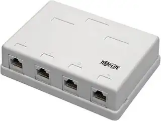

  • Drill a hole outside the box just big enough to get the ethernet cables through. If you are concerned about cracks near the existing box, make the new hole a few inches away.
  • Use surface mount ethernet jacks, such as these from Amazon (example for picture):
TrippLite 4-port surface mount ethernet jacks
Just realized the bottom connector is coax. There are surface mount boxes for those too, or you can do the typical industrial/basement look: Mount a standard 4" steel box on the wall and put on an appropriate cover that can hold a Decora style device (i.e., the same thing you would use for a GFCI/receptacle) and reuse the existing 2 ethernet + 1 coax plate.

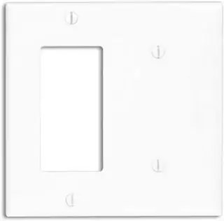

    I can tell you put a lot of detail into this answer, and I appreciate that. The chief concern I've gathered from your answer is that high voltage wires could come lose and touch low voltage wires in the box. That is something I have not considered, and although it is unlikely, it is certainly possible and should be protected against. Therefore, at a minimum a electrical box with a separator that is designed for the box is required. Although this falls short of your recommendation, I consider this to be the minimum. However I agree that it is ideal to handle low and high volt wires separate. – user1509669 Sep 19 '22 at 01:55
    Yes, a minimum is an appropriate divider (UL or ETL listed or similar, ideally made for/approved specifically by the manufacturer of the 2-gang box). But really, pull the low voltage stuff out, surface mount it and call it done. The risks are not insignificant and if there were ever a fire or other serious problem, this would be found pretty quickly and insurance would not be too happy with that. Low voltage wiring has almost no rules except "keep away from 120V+ voltage". – manassehkatz-Moving 2 Codidact Sep 19 '22 at 01:59
    That faceplate configuration would be just fine is combined with a box like this: https://www.lowes.com/pd/Southwire-2-Gang-Multi-Mount-Adjustable-Depth-Device-Box/5001786771 which specifically provides the feature "Low voltage wall dividers allow for mixed voltages in the same box". I agree it definitely should never be done with the box he has. This one would also be ok, and really shows how "no requirements" the LV side has: https://www.lowes.com/pd/CANTEX-2-Gang-Dual-Voltage-Box-BRKT/5001724919 – Ben Voigt Sep 19 '22 at 16:28
  • @BenVoigt The orange one looks perfect for this - I particularly like that the low voltage side is simply open. However, it is (a) designed for mounting into studs and not masonry and (b) is [plastic instead of metal](https://diy.stackexchange.com/questions/256189/why-not-use-a-plastic-receptacle-box-for-an-outdoor-outlet/256190?_gl=1*1colr08*_ga*MTI2Njg4MDA4MC4xMzcxMDk4NjQ1*_ga_WCZ03SZFCQ*MTY2MzU5OTkyMi40MC4xLjE2NjM2MDU0MDQuMC4wLjA.#256190). – manassehkatz-Moving 2 Codidact Sep 19 '22 at 16:37
    Would there be any code problems if the double-width box were replaced with a single-width box, and the networking connections were mounted to a double-width plastic faceplate which covered up the box and the void space next to it? – supercat Sep 19 '22 at 17:37
  • @supercat I think that would be perfectly fine. Ben Voigt's second link is similar to that, and I also mentioned * one real box (for 120V AC) and one box eliminator (for ethernet)* in my answer as an OK situation. The catch is that normally the receptacle (or other device) attaches to the box and the faceplate (including multi-gang) goes on after the devices. But two *separate* boxes or box + box eliminator normally requires more width than a 2-gang box. – manassehkatz-Moving 2 Codidact Sep 19 '22 at 17:43
  • @manassehkatz-Moving2Codidact: My idea would be mount the Ethernet jacks to a plastic faceplate which would in turn be mounted to a single-wide junction box, thus foregoing the need to use a box eliminator as a mounting point and avoiding the mechanical width issues a box eliminator would pose. – supercat Sep 19 '22 at 17:49
  • @supercat Two side-by-side single boxes can *also* have width issues - a standard 2-gang faceplate is designed for a 2-gang box, not 2 single-gang boxes. That being said, the difference is not much, and a narrow box (like some old ones in my house that I've been replacing for the low voltage side might work. – manassehkatz-Moving 2 Codidact Sep 19 '22 at 18:05
  • @manassehkatz-Moving2Codidact: My suggestion was to simply not have *anything* other than a void space behind the Ethernet connector. Not use a box and a box eliminator, or two separate boxes, but simply a box and nothing. A box eliminator would facilitate mounting of a jack and faceplate if there were nothing else to which either could be mounted, but otherwise there's no requirement to have anything behind an Ethernet jack. – supercat Sep 19 '22 at 18:20
    Alternatively, if you don't like that half-blank panel, you could always install a second 120VAC outlet pair into the box. Doesn't solve the "where to put the ethernet jack" question, but more outlets might be useful provided they're all wired up correctly. – Darrel Hoffman Sep 19 '22 at 21:01
