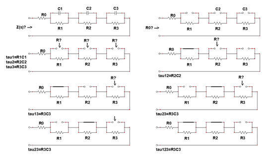

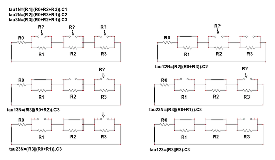

You start in dc, with \$s=0\$ in which you open all caps. It is easy here and you sum all resistors. Then you have to determine the time constants in various conditions once the stimulus is turned off. In an impedance determination, the stimulus is a test generator \$I_T\$. When turned it to 0 A, it becomes open-circuited and you are left with a simple circuit as shown below:
For the zeroes, an impedance represents an easy case because you have to null the response across the current source to determine the time constants in this mode. A nulled current source (0 V across its terminals) can be conveniently replaced by a short circuit. It is a so-called degenerate case. The new circuit is shown below and what you have to do is determine the resistance \$R\$ in these various conditions:
Finally, you assemble all these time constants to form a low-entropy expression as shown in the below sheet:
And if you plot all expressions, you have the general shape:
The difficulty here is to reorganize the expressions to unveil poles and zeroes by approximating the response. You need to check the time constants and see which ones dominate or can be grouped together. Good luck with this exercise!
