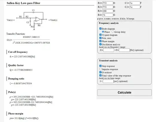

I'm trying to figure out the R and C elements for a second-order Bessel filter approximation. Unfortunately, in the below calculations the quality factor is negative, so it is wrong? (I checked by entering the values ​​into this design tool.)
Also, the poles have a positive real part.

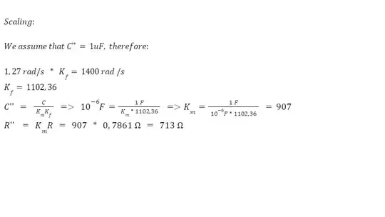

In my calculations, I used the tips from this video.
I often come across the concept that the coefficients in the filter table are for the normalized form of the filter. What does that mean? I read somewhere that they were designated for RC = 1 (or it depends?). In the above example I assumed RC = 0,7861. Is that true?
You have chosen to have a gain greater than three (\$1+\frac{R4}{R3}\$). Sallen Key circuits cannot have a gain equal to or greater than 3. I expect this is why the Okawa Denshi web site calculator got into a quandary. Try making R4 = R3 and see what happens. If you make R3 = 501 Ω (AV = 2.996) then you get a massive Q factor of 250.5 and, if you drop R3 to 500 Ω, Q becomes infinite.
The maximum gain (AV) of 3 comes from this relationship: \$A_V = 3 - \frac{1}{Q}\$

You ask about a 3rd order Bessel yet you show a 2nd order schematic. First you need to determine the transfer function based on your requirements. And, since this is a Bessel filter then you should know that, usually, these filters are not built for their -3 dB corner frequency but for their flat group delay.
Because you are using that table, which comes from "Opamps for everyone, Ron Mancini" (freely available, last I checked), I'll assume you are looking for a Bessel filter that satisfies a -3 dB @ 225 Hz (as per the poles displayed in your results from the Okawa-Denshi site).

The problem comes with the gain for that particular topology (Sallen-Key): it's restricted due to its transfer function, you can see that the term \$k\$ appears in the coefficient for the \$Q\$.
Therefore, you could try a different topology, for example the multiple-feedback (on the same site) which is also more stable. You should know that Sallen-Key has a particularly annoying "feature": at high frequencies, the feedback capacitor has a low impedance and the output appears more and more at the input, causing a high-pass response. I warmly recommend simulating that, because words do not do it justice. I'll leave it to you to discover.
