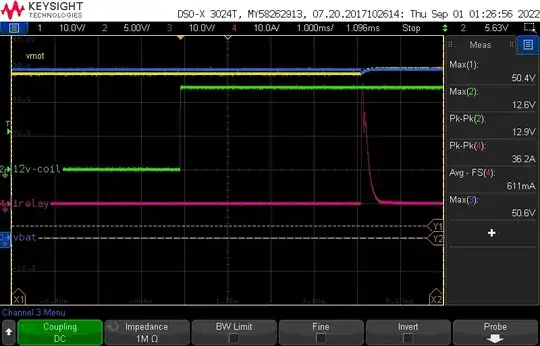

Oscilloscope measurements:
  • 12 V coil is measured with differential probe across the relay freewheeling diode.
  • Vbat is in blue and battery voltage.
  • VMOT is the RY_REAR_MOT
  • I_RELAY is measured with current probe at the point marked in the block diagram (output of relay).
Measurement 1- triggered on coil being energised (30 s after powering on system):
test
Measurement 2 - Triggered on coil de-energised (system turned off):
Measurement 3 - Long capture to show the motorcontroller precharging. You can also see the relay energise after 30 s:
No voltage differential is observed across the contacts of the relay. I have ordered a datalogger and will try to capture events in operation but again, failures have not happened whilst motors are being spun.
The oscillograph indicates a 36.2A spike of current through the switch ~4ms after the relay coil is energized. This is near the limit for the switch with a capacitive load. The battery voltage drops an it appears that the motor is starting to turn. I speculate that this is the motors' starting current. The pulse starts to decrease very fast then oscillates a bit before decaying. I speculate that this is a switch bounce followed by an arc as the switch closes. This would seem the culprit for the damage. This may exceed the contact current rating from pulse to pulse.
The blue battery trace makes no sense. When the relay is de-energized the coil current flows through the diode, shown by the small negative voltage just after the trigger. About 1/2 way through this region a 5A peak oscillation occurs (pink line) indicating an arc while the switch is opening. The switch should be able to handle this current level.

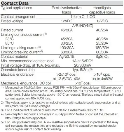

  • r.e. the 36A spike: The relay datasheet quotes a "Limiting making current" of 180/60A for capacitive loads depending on using the NO/NC contact. [TE's definitions](https://www.te.com/commerce/DocumentDelivery/DDEController?Action=srchrtrv&DocNm=Definitions_Relays&DocType=SS&DocLang=EN) claim that's subject to a 20ms max, which is a lot longer than the spike in OP's graph. – mbrig Sep 01 '22 at 02:54
  • @Hasman404: Which relay do you have: Contact type: AgNi0.15 or SgSnO2 – RussellH Sep 01 '22 at 03:31
  • @RussellH Its AgNi0.15 but using the NO contact so still rated well over the spike seen. – Hasman404 Sep 01 '22 at 05:46

Here's the relay contact data.
The limiting 'continuous wattage' (12 V * 45 A = 540 W), 'making wattage' (12 V * 100 A = 1200 W) and 'breaking' wattage (12 V * 60 A = 720 W) may have been surpassed in your application.
