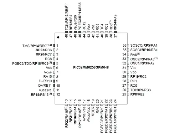

Here is another example of a PIC32MM:
PIC32MM
This one is so chaotic you can't find 5 pins straight in a row!

    It should be noted that the PIC32 part in the original question does in fact have a VDD/VSS pin pair on three sides of the chip (which supports what this answer says). – user4574 Aug 28 '22 at 15:04
