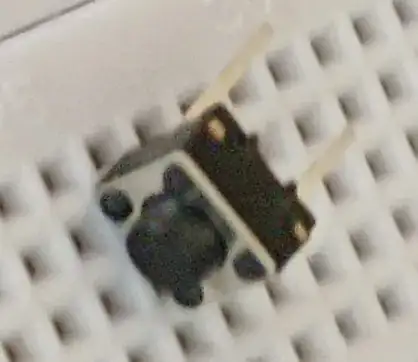

I have bought single push buttons in India for 1 rupee a piece, that's a penny or so. They are seemingly very basic (you can see them around here other question). I might follow up here with more details. I also bought a supposedly 100 MHz digital scope HTC brand. It being the first time I have a digital scope in single mode, I tried to visualize the button bouncing.
Strange thing is I could not. I was able to fry a chip's input by a series capacitor from button tied to high to input pin, pushing the button a few times to often. But I never once saw a single bounce. Compare this with my desperate attempts of building various de-bouncing circuits with various buttons I had before, I am flabbergasted. Should I worship the buttons for magically being bounce-free or should I mistrust my scope? The scope did show me 100-nanosecond sized events, so I can't really find evidence of fault with it. But I have no experience with what tricks cheap digital scopes might play on us.

I will follow up on this with my bounce counter to verify. But wanted to ask if bounce-free buttons have ever been seen in the wild? So you don't go off on high-tech DOD-classified area 51 unicorn buttons, this is how naive they look:

If you set horizontal scale too-fast, you may see only one bounce edge, and miss others. Shown below is a button-release 'scope capture, from a tactile push switch looking very much like the OP's photo. A 47k pull-up resistor went to a +5V DC supply: scope trace of button release showing bounce
I noted that a few pushes and a few releases were apparently bounce-free. The capture shown was roughly typical. Button pushes had a higher percentage of bounce-free edges than button releases.
Note that the full-span width is 3.2ms.
