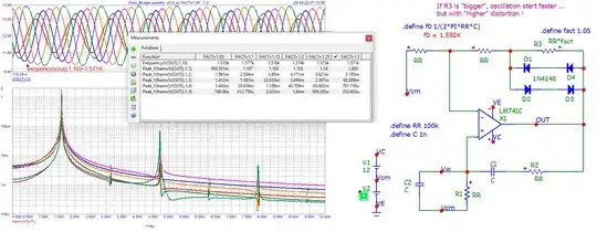

Here is a "general" circuit. Just switch whatever you want.
A parameter is also used (Fact) for seeing when/how oscillation starts (condition).
Made with a FREE simulator microcap v12 with interactive capabilities.
And with Bipolar supplies, Note that the oscillator does not start in the same way.
Added harmonic distortion of the SECOND oscillator (h1,h2,h3,h4,h5).
Antonio51
  • 11,004
  • I just built this, it works good, the harmonic distortion is lower than I expected, the 3rd harmonic is -40 dB, only a little more than the light bulb method. My frequency adjustment with a ganged pot isn't working too well, probably because my cheap pot isn't tracking well. – Mattman944 Aug 25 '22 at 15:49
  • If the gain is too "high" then the harmonic distortion is higher. I add the calculated distortion for reference in the answer. – Antonio51 Aug 25 '22 at 21:17
  • NB: the feedback with the diodes can be changed for minimal distortion, but it takes time to find the "best" network (probably the "parabolic" function) – Antonio51 Aug 26 '22 at 05:39
