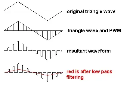

There are other options that can be pursued of course. For instance, it's quite easy to make a single-quadrant, analogue squaring circuit using op-amps, analogue-switches and pulse width modulation. This can be shown if requested but, here's a link to what I've said previously. Summary picture: -

This would be the general form of an analogue circuit using PWM to calculate power: -
On the final graph above I've plotted a red horizontal line corresponding to 0.7071 volts. As you can see, the RMS output hits the target pretty accurately. In case you want to inspect the PWM on the half-wave: -
Hopefully, you should be able to recognize that when the squared waveform is low in value, the PWM duty cycle is nearly zero. When the squared waveform is near the peak of 1 volts, the PWM duty cycle is nearly unity.
When filtered lightly you would see a nice sine-shaped waveform of twice the frequency of the input (50 Hz) and centred at 0.5 volts. Why 0.5 volts; because, if the root-mean-square output is 0.7071 volts (as we would expect) then the mean-square value would be 0.5 volts.

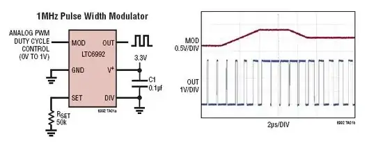

  • excuse me but I don't understand how LTC6992 (pulse width modulation (PWM)) can be used in the process to get the RMS value. How to use your last op-amp squaring circuit? – philfs Aug 23 '22 at 18:03
  • @philfs I've added a typical circuit that can be used to generate RMS. – Andy aka Aug 23 '22 at 18:19
  • @philfs PWM-ing a voltage is same as multiplying the duty cycle by that voltage. So if you use a voltage to control PWM duty cycle, and module that same voltage using PWM, you get squaring. Very accurate squaring if done correctly - can be accurate to 5-6 decimal digits easy if you wish, although the bandwidth will be low. – Kuba hasn't forgotten Monica Aug 23 '22 at 18:49
