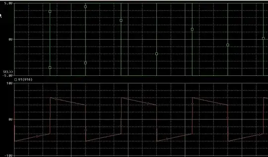

So I recreated the circuit in LTspice, and it doesnt work at all, nothing on the output or any part of the RC network; though this could also be due to me messing something up, so here's the LTspice schematic, just in case:
So if it isn't because i messed up the simulation, why exactly doesn't this circuit work?

In your LTspice simulation set Rser for V1 equal to zero. Then it will work.
RussellH
  • 12,496
  • While setting Rser=0 worked it seemed odd to me, as in a real world situation you don't ever have 0 series resistance, but then I tried it with Rser=1k again and it worked so it was probably just me getting some other thing wrong. – Baldo Aug 22 '22 at 14:00
