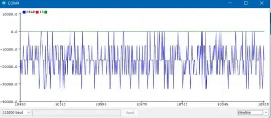

The microphone worked exactly once. Now, the microphone outputs random, but seemingly periodic values.
Serial Plotter, showing graph of random output
Note the output here is all negative. The one time it worked, the output created an almost sine-wave-like graph, ranging from positive to negative.

Here is the output from the Serial Monitor:
-20479.50
READ IS: 0
-24575.00
READ IS: 0
-16384.00
READ IS: 0
-24576.00
READ IS: 0
-24576.00
READ IS: 0
-32768.00
READ IS: 0
-12287.00
READ IS: 0
-20480.00
READ IS: 0
-16384.00
READ IS: 0
-16384.00
READ IS: 0
-4096.00
READ IS: 0
-12288.00
READ IS: 0
-8191.00
READ IS: 0
-16383.00
READ IS: 0
-4096.00
READ IS: 0
-12288.00
READ IS: 0
-16384.00
READ IS: 0
-12287.00
READ IS: 0
-12287.00
READ IS: 0
-8191.00
READ IS: 0
-4095.00
READ IS: 0
-28671.00

  • When doing embedded work be VERY VERY suspicious of values == 2^n or 2^n - 1, these are saturation values and can indicate that you're not deserializing data correctly. I am suspecting that you are getting the endien incorrect with the received data. Also since you're not printing the actual data but only the mean, calculate a min and a max while you're at it - it may yield some insight. – Bryan Aug 24 '22 at 20:56
  • @Bryan What do you mean by endien? Do you mean the endian? – Sunzeri225 Aug 26 '22 at 00:43
I think the first thing to rethink is what i2s_read will return to you.
If we take a peek in the GitHub of Espressif and go to the i2s part, you can see for the new master version: (i2s_channel_read is the new name of the function i2s_read, but practically the same)
esp_err_t i2s_channel_read(i2s_chan_handle_t handle, void *dest, size_t size, size_t *bytes_read, uint32_t timeout_ms)
    I2S_NULL_POINTER_CHECK(TAG, handle);
    ESP_RETURN_ON_FALSE(handle->dir == I2S_DIR_RX, ESP_ERR_INVALID_ARG, TAG, "this channel is not rx channel");
    esp_err_t ret = ESP_OK;
    uint8_t *data_ptr;
    uint8_t *dest_byte;
    int bytes_can_read;
    *bytes_read = 0;
    dest_byte = (uint8_t *)dest;
    /* The binary semaphore can only be taken when the channel has been enabled and no other reading operation in progress */
    ESP_RETURN_ON_FALSE(xSemaphoreTake(handle->binary, pdMS_TO_TICKS(timeout_ms)) == pdTRUE, ESP_ERR_INVALID_STATE, TAG, "The channel is not enabled");
    while (size > 0 && handle->state == I2S_CHAN_STATE_RUNNING) {
        if (handle->dma.rw_pos == handle->dma.buf_size || handle->dma.curr_ptr == NULL) {
            if (xQueueReceive(handle->msg_queue, &(handle->dma.curr_ptr), pdMS_TO_TICKS(timeout_ms)) == pdFALSE) {
                ret = ESP_ERR_TIMEOUT;
                break;
            handle->dma.rw_pos = 0;
        data_ptr = (uint8_t *)handle->dma.curr_ptr;
        data_ptr += handle->dma.rw_pos;
        bytes_can_read = handle->dma.buf_size - handle->dma.rw_pos;
        if (bytes_can_read > (int)size) {
            bytes_can_read = size;
        memcpy(dest_byte, data_ptr, bytes_can_read);
        size -= bytes_can_read;
        dest_byte += bytes_can_read;
        handle->dma.rw_pos += bytes_can_read;
        (*bytes_read) += bytes_can_read;
    xSemaphoreGive(handle->binary);
    return ret;
You see the buffer is cast to uint8_t, so just bytes.
Now comes the tricky part; changing two uint8_t to a uint16_t is simple. Like:
uint8_t msb,lsb;
uint16_t result;
result = msb << 8 | lsb;
But an uint16_t is not an int16_t.
I’m not chewing everything for you now, try to find that answer as well here. You will find a very extensive answer. But it’s super informative to learn by yourself!
Oh. And reading the buffer: lsb is first. Msb second. And so on.
