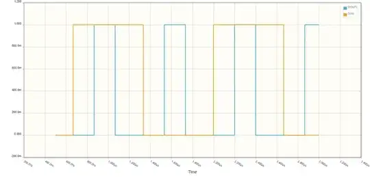

The output switches on each input edge.
Input and output waveforms
If the initial delay is too long, then another option is to use 74HC86 + 74HC244:
simulate this circuit

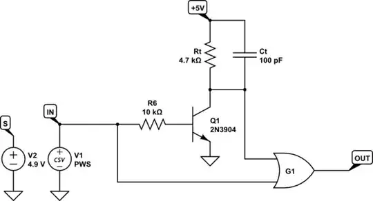

My go-to method for extending a pulse with RC uses a transistor to short the capacitor. That offloads the burden of capacitor discharge current onto something a lot more capable:
When its base is brought high, Q1 discharges Ct very quickly, which brings the input to U2 almost instantly low. After Q1's base returns low, the capacitor recharges sedately via Rt, which delays the return to a high state of U2's input.
This thing's even resettable mid-pulse; on the graph see how a second input pulse that arrives before the output returns to zero causes the pulse to duration to be extended by the full amount.
Since these transitions are quite fast, even with the "slow" charging of Ct, probably fast enough to avoid oscillation of U2. However, I would strongly recommend that U2 be a schmitt trigger input device, to keep its output transitions nice and sharp.
I think input IN should be OK from a 74LS output (U1). I couldn't tell you how long the pulse would last if U2 is a heavy 74LS load, but if U2 is a 74HC device, the output pulse duration will be about 1RC.

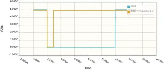

Edit: Long input pulse, short output pulse
Notes: Ignore voltage source V2 (node S) in these diagrams, it's just there to get the graphs right. When using capacitive timing elements, which are rapidly charged or discharged (with a transistor, or diode clamp, for example) you need to ensure that the power supply is sufficiently decoupled nearby. Otherwise you'll mess up the supply rail voltages shared by the entire system. I recommend a ceramic capacitor of an order of magnitude greater than the timing capacitor, directly across the supply rails nearby.
First, take a look at using an RC differentiator, whose output is diode clamped to within the supply rails:
Here we differentiate the input signal, producing a short negative going pulse as the input falls, and a positive going pulse when the input rises. The pulses are offset by +5V, and we suppress the positive pulse with D1.
This almost certainly will not work with IN coming from a 74LS output, because IN must be a near-full amplitude 5V to 0V transition.
