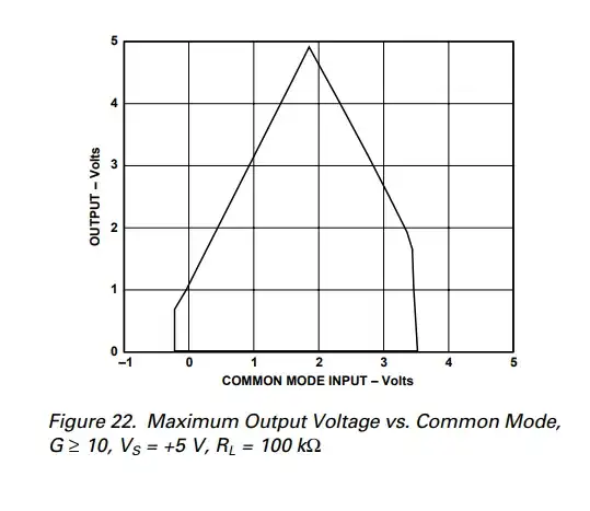

You have need high-precision resistors.
Why don't use some high common voltage op-amp as INA149?
Already in and well "paired".
Antonio51
  • 11,004
  • I don't quite understand how this solves my problem. Looking at the datasheet, I suppose I power it with 5 V (V+ = 5 V; V- = 0V), which would give me an input voltage range of -20 to 25 V (common-mode) and an output voltage range of 1.5 to 3.5 V. That doesn't seem like what I want. And this IC only provides half of the solution anyway (the differential amplifier). I would still need to combine this with a resistive voltage divider to drop the output, right? Maybe you can add more explanation about what the advantage? Just eliminating need for separate high-precision resistors? – Cody Gray - on strike Aug 16 '22 at 07:46
