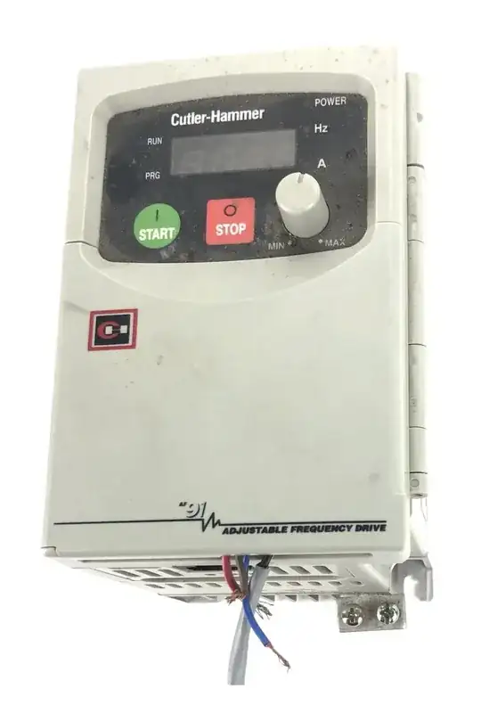

I am looking to buy a Cutler-Hammer "Adjustable Frequency Drive" AF91AGO BF25D. I’m a bit confused even after going through its datasheet. Can the output voltage of this VFD be varied from 0-230 V, or is it fixed between 220-230 V? I saw another VFD (a Schneider Electric "Altivar" ATV12H037F1) that says it can vary from 0-240 V, this got me confused.
Sorry, I haven’t used a VFD before. I’m looking to obtain this to get a 3 phase, 115 V, 400 Hz supply to power up some avionics.

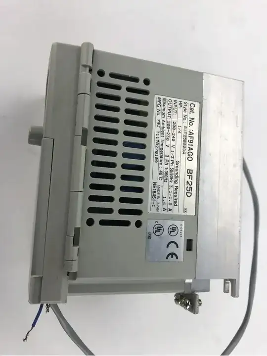

On page 1-4 we have the same information you can see on the nameplate. The rated output voltage is 200-240 V, three-phase, with a note that indicates that this range is a function of the input voltage. So, no, the output voltage cannot be varied outside of those bounds.
We can also see from the nameplate and page 1-6 that the output frequency range is 0.5/1-360 Hz. Not quite 400 Hz.
