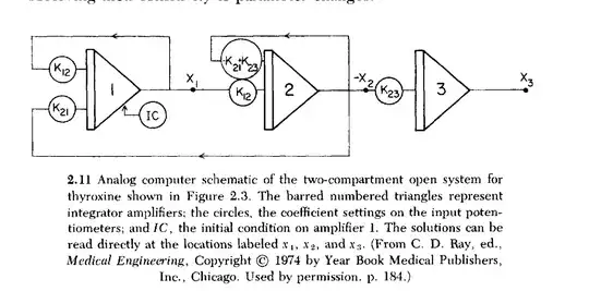

How to translate compartmentalized liver to analog computer? I just want to learn to translate the figure to equations.
This is the question:
International source:
The compartmental analysis figure is the diagram that I want to translate to differential equations and eventually analog computer.
This is from mathematical models in the health sciences book by Eugene Ackerman.
I don’t know about the author, but I bet that this is extremely reliable compared to the materials locally available and written by local authors. But it doesn't tell which equation it is modeling, so I am not 100 % sure about it. But to be honest, I don't clearly understand its conventions and it's age old book which is un-updated, so relying on it would be a mistake.
It has problems as well:
It doesn't use negative for $$K_{12}$$ And idk why is it using negative for $$K_{23}$$.
Less reputed source:
This is pretty ambiguous, their equation and figure don't even match.
If $K_{21}$ is negative then $$K_{23}$$ should also be negative(although it doesn't writes that in its equation.
I can guess that it's trying to subtract the net output instead of doing it individually, but I'm not sure why it's doing it.

You really want to read an analog computer introductory material from that era. There is a lot of unspoken convention in those diagrams. For example, all summers (triangles) are assumed to be inverting, and same goes for integrator inputs (triangles with a vertical bar). That's because the implementations used inverting amplifiers, to reduce the number of stages needed. E.g. an inverting integrator can be done with just one high-gain inverting stage.
To understand analog computation diagrams - which are their own technical language and are not circuit diagrams! - see e.g. A Practical Approach to Analog Computers by Strong and Hannauer. You won't go very far without trying some simple examples using e.g. SPICE or on a breadboard.
The translation between the differential equations and integrators is also a specific process tailored to the building blocks available in an analog computer.
For numerical solutions, there's no need to translate differential equations into equivalent analog circuits. I.e. if you can look up a reference on liver physiology that's tailored towards bio-modelling, you'll get the differential equations, and then you can either solve them directly using Octave, Mathematica, etc., or use a reference on analog computing to translate them into an analog computation diagram.
It doesn't use negative for K12. And idk why is it using negative for K23.
Potentiometer coefficients were usually positive-only, between 0 and 1. Inversions, if needed, were done using summer blocks. A triangle without a bar is a summer, and if the gains are not shown, they are -1 by default. Summers typically had inputs with gains of -1 and -10. The negative sign was not written out explicitly! This is the language that publications that used analog computer models would use, the language that the analog computer application notes used, the language that anyone doing anything with analog computing had to learn, since it mapped almost 1:1 to the configuration of the hardware the problem would run on. That's how you'd read that publication from the 70s. The later stuff is, sadly, too often regurgitated without the wherewithal to spend an hour or two read the free contemporaneous introductory materials.
So, a summer element with a "-" sign in the middle is a creation of someone who doesn't know what they are talking about, pretty much :(
Analog computation diagrams do not have "positive" and "inverting" summers, nor are there separate inverters. The "summer" and "inverter" symbols from the diagram you cited are bogus:
Do Not Use These Symbols Like This!
You've also shown this part of the diagram:
K21 is not negative, because K21 is a pot with a value between 0 and 1. All inputs to the integrator are inverting by convention.
The liver model, redrawn with implied conventions made explicit, is:
The integral equations that it models are:
$$ \begin{aligned} X_1(t) &= \int{-K_{12}X_1(t) - K_{21}(-X_2(t)) {\,\rm d}t} + {I\!C}_1, \\ -X_2(t) &= \int{-(K_{23}-K_{21})(-X_2(t)) -K_{12}X_1(t) {\,\rm d}t}, \\ X_3(t) &= \int{-K_{23}(-X_2(t)) {\,\rm d}t}. \\ \end{aligned} $$
Simplifying a bit:
$$ \begin{aligned} X_1(t) &= \int{-K_{12}X_1(t) + K_{21}X_2(t) {\,\rm d}t} + {I\!C}_1, \\ X_2(t) &= \int{K_{12}X_1(t) + (K_{21}-K_{23})X_2(t) {\,\rm d}t}, \\ X_3(t) &= \int{K_{23}X_2(t) {\,\rm d}t}. \\ \end{aligned} $$

  • @Kubahasn'tforgottenMonica 1) Why is ouput of 1st integrator x1 positive but the output of 2nd integrator x2 negative? It's as per the equation but idk why, but I feel sth is missing. 2) In the analog block diagram, does it make a difference if we use either of K21-K23 or K23-K21, my main confusion was this(Although I learnt a lot from your answer). Since both are going outwards(in the first liver model 3 piece-block diagram), shouldn't they have same sign? – pravatpandey Jul 30 '22 at 03:26
  • @Mattman944 There're literally 0 materials(ofc there're some like 3-4 but not clear) about this online. I think this is perhaps in the book by naim kheir about simulation, but that buying that ebook will cause me bankruptcy. – pravatpandey Jul 30 '22 at 03:29
  • @Kubahasn'tforgottenMonica I edited my 2nd question-: 2) In the analog block diagram(or in the modeling equation), does it make a difference if we use either of K21-K23 or K23-K21, my main confusion was this(Although I learnt a lot from your answer). Since both are going outwards(in the first liver model 3 piece-block diagram), shouldn't they have same sign? – pravatpandey Jul 30 '22 at 03:36
  • The symbols used are similar (to the slide of local author I told who was reliable) in geoffrey gordon texbook system simulation. He calls this "analog method" instead of "analog computers" in the title. – pravatpandey Jul 30 '22 at 07:39
