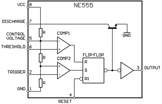

I am trying to find the gain (Vout/Vin) of the circuit below, this is not a real circuit that I have, I am just trying to learn more about circuit analysis. The circuit reminds me of a cascode circuit where the gates are the same potential instead of one being Common Gate.
How/where do I start to derive this?
Why is M1 in triode region?
Why is M2 in saturation region?
I did a small signal model analysis followed by short circuiting the output to ground. I followed this up with inserting a test voltage and setting vin to 0V.
Out of this, I got a gain of gm1*(ro1+ro2) . However I am not sure if this is correct. Any help is appreciated

Why is M1 in triode region? Why is M2 in saturation region?
Start by assuming same W/L ratio for both devices. Then, if you imagine that both devices have a specific Id vs Vds curve for one specific Vgs and Ir, then each has one specific Vgs that will give Ir for the specific W/L and Vgs.
If this is true (which it is), then you can see that if vin = Vgs1 the voltage at the gate only has enough voltage to supply one full Vgs to both devices, but the M2 would have 0 volt left to supply M1 vds > 0. And M1 vds needs to be a minimum value to be saturated. So right away, M1 cannot be saturated.
M1 has a fixed Id vs Vds curve for a fixed Vgs, but M2 can adjust it's Vs, or equivalently, shift its specific Vgs curve, to get both devices to some operating point to have the same Id (via loop feedback in the circuit configuration).
Now, M1 will move backwards on it's fixed (Vgs) Id vs Vds curve until both currents equalize to a lower value and M1 moves all the way to triode, the top device M2, will adjust by shifting its Vgs (by adjusting the s value and hence Vd to M1) to give equivalent Id as this new M1 operating point in triode. So top device M2 is now is still in saturation (but on a shifted Id/Vds Vgs operating curve), and M1 is the original Id/Vds Vgs curve but operating way back in triode. You'll also notice the original expected current is no longer the same, because the current had to drop for the devices to equalize to the same current.
