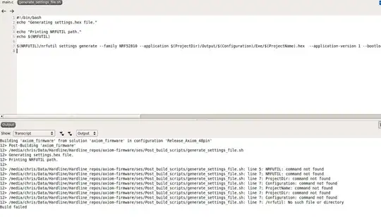

But, I am unable to access it from a post build script:
Why can't my script find my global macro?

I think you should be using curly braces instead of parentheses around your variable names: ${NRFUTIL} instead of $(NRFUTIL).

The solution I found that worked for me was to explicitly pass the necessary macros to my script as parameters when the script is called.
My post build command:
../Post_build/post_build.sh $(NRFUTIL) $(ProjectDir) $(ProjectName) $(Configuration) $(SigningKey)
Then, in my post build script, I pass those parameters to local variables within my script:
#!/bin/bash
NRFUTIL=$1
ProjectDir=$2
ProjectName=$3
Configuration=$4
SigningKey=$5
Application_file_path=$ProjectDir/Output/$Configuration/Exe/$ProjectName.hex
DFU_zip_file_path=$ProjectDir/../Post_build/Outputs/$Configuration/DFU_package
echo "Generating DFU package."
nrfutil pkg generate --application-version 1 --application $Application_file_path --hw-version 52 --sd-req 0x0103 --sd-id 0x0103 --key-file $SigningKey $DFU_zip_file_path/$ProjectName.zip
