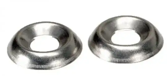

When I was really young, just getting into electronics, my Mother gave me a wooden board, some screws, and a bunch of these:
I got that picture from this supplier: allfasteners.com
They are called "countersunk washers", and can be used with regular countersunk wood screws to pinch down onto multiple wires or component leads, connecting them together.
Perhaps that's an option for you.

  • I recall doing something similar in school in the early 90s. Another term is "cup washers" – Chris H Jul 25 '22 at 07:59
    The excellent ladybird book [Making a transistor radio](https://worldradiohistory.com/BOOKSHELF-ARH/Author-Groups/G.C.Dobbs/Making-a-Transistor-Radio-Dobbs.pdf) is the reason I have had a 40+ year career in electronics and software. These screw cup based connections were the basic method used in the project. – uɐɪ Jul 25 '22 at 13:49
