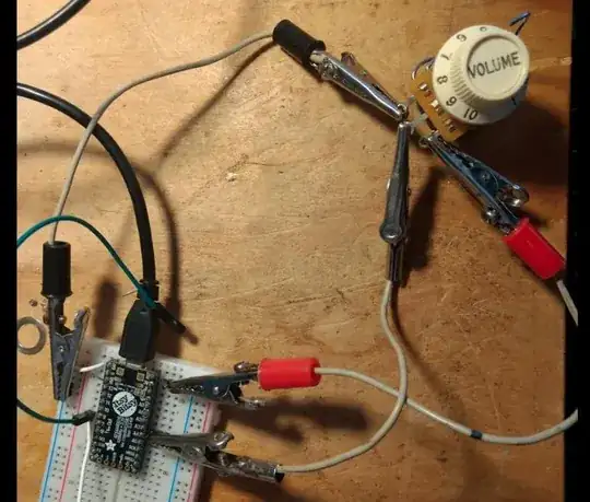

I used:
  • an ItsyBitsy M4 microcontroller's 3V pin to provide a fixed 3.3VDC which served as a "signal",
  • a Fender S1 potentiometer as a volume control
  • the Itsy's A4 analog input to measure the voltage from the centre tap of the volume pot

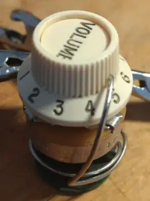

I adjusted the volume control in 42 increments of approximately equal rotation (corresponding to the knurled ridges on the knob). At each increment, I measured the voltage by taking 32 readings from the A4 pin in quick succession. The graph below plots the average and range from each increment.

Here's my experimental setup experimental setup
Here's a close-up of the volume control, showing the knurls which determined the increments potentiometer
